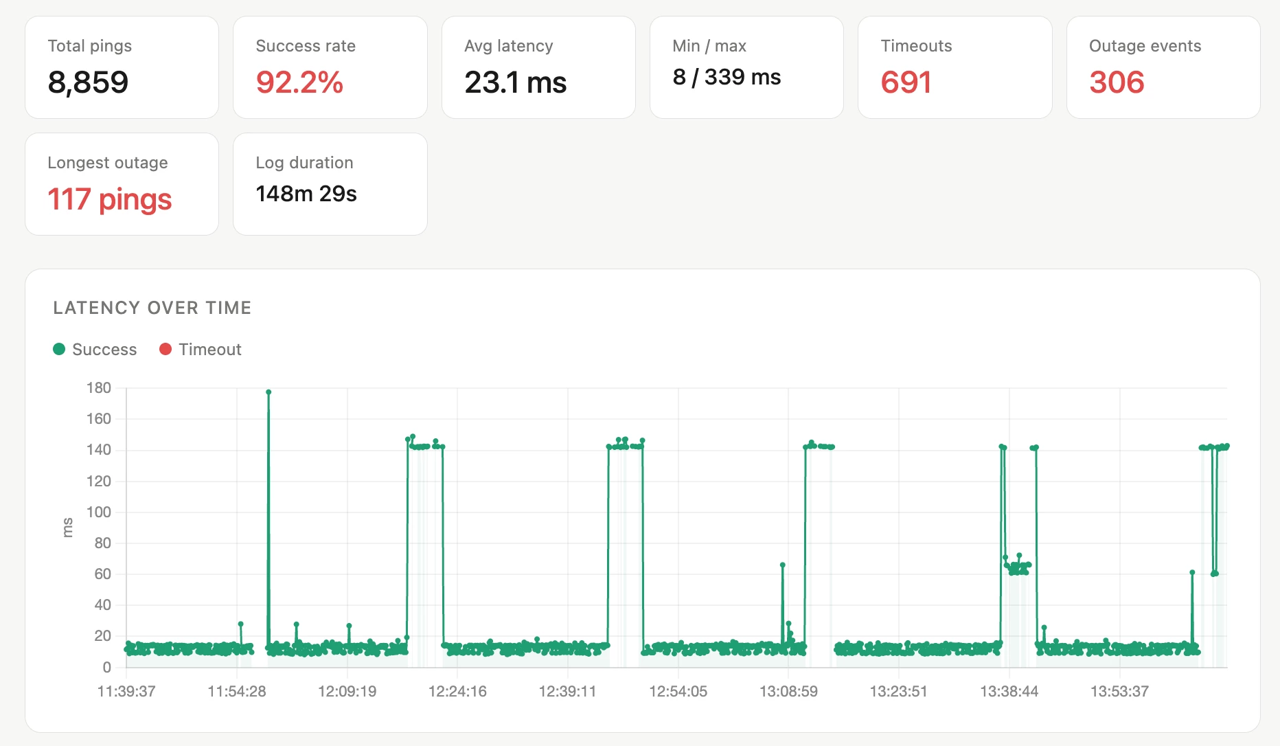

Als ik de afgelopen uren ping -t uitvoer, krijg ik blokken met de volgende uitvoer, terwijl het internet tegelijkertijd niet reageert.:
Wed Jun 10 13:14:41 CEST 2026 - Request timeout for icmp_seq 5667
Wed Jun 10 13:14:41 CEST 2026 - 64 bytes from 8.8.8.8: icmp_seq=5668 ttl=119 time=145.702 ms
Wed Jun 10 13:14:43 CEST 2026 - Request timeout for icmp_seq 5669
Wed Jun 10 13:14:43 CEST 2026 - 64 bytes from 8.8.8.8: icmp_seq=5670 ttl=119 time=142.429 ms
Wed Jun 10 13:14:45 CEST 2026 - Request timeout for icmp_seq 5671
Wed Jun 10 13:14:45 CEST 2026 - 64 bytes from 8.8.8.8: icmp_seq=5672 ttl=119 time=142.021 ms
Wed Jun 10 13:14:47 CEST 2026 - Request timeout for icmp_seq 5673
Wed Jun 10 13:14:47 CEST 2026 - 64 bytes from 8.8.8.8: icmp_seq=5674 ttl=119 time=142.164 ms
Wed Jun 10 13:14:49 CEST 2026 - Request timeout for icmp_seq 5675
Wed Jun 10 13:14:49 CEST 2026 - 64 bytes from 8.8.8.8: icmp_seq=5676 ttl=119 time=141.757 ms
Wed Jun 10 13:14:51 CEST 2026 - Request timeout for icmp_seq 5677
Wed Jun 10 13:14:52 CEST 2026 - Request timeout for icmp_seq 5678
Wed Jun 10 13:14:53 CEST 2026 - Request timeout for icmp_seq 5679
Wed Jun 10 13:14:53 CEST 2026 - 64 bytes from 8.8.8.8: icmp_seq=5680 ttl=119 time=142.195 ms
Wed Jun 10 13:14:54 CEST 2026 - 64 bytes from 8.8.8.8: icmp_seq=5681 ttl=119 time=142.251 ms
Wed Jun 10 13:14:55 CEST 2026 - 64 bytes from 8.8.8.8: icmp_seq=5682 ttl=119 time=142.019 ms
Wed Jun 10 13:14:57 CEST 2026 - Request timeout for icmp_seq 5683
Wed Jun 10 13:14:58 CEST 2026 - Request timeout for icmp_seq 5684
Wed Jun 10 13:14:59 CEST 2026 - Request timeout for icmp_seq 5685
Wed Jun 10 13:14:59 CEST 2026 - 64 bytes from 8.8.8.8: icmp_seq=5686 ttl=119 time=144.154 ms
Wed Jun 10 13:15:00 CEST 2026 - 64 bytes from 8.8.8.8: icmp_seq=5687 ttl=119 time=142.282 ms
Wed Jun 10 13:15:02 CEST 2026 - Request timeout for icmp_seq 5688
Wed Jun 10 13:15:03 CEST 2026 - Request timeout for icmp_seq 5689
Wed Jun 10 13:15:04 CEST 2026 - Request timeout for icmp_seq 5690
Wed Jun 10 13:15:04 CEST 2026 - 64 bytes from 8.8.8.8: icmp_seq=5691 ttl=119 time=142.480 ms
Wed Jun 10 13:15:06 CEST 2026 - Request timeout for icmp_seq 5692
Wed Jun 10 13:15:06 CEST 2026 - 64 bytes from 8.8.8.8: icmp_seq=5693 ttl=119 time=142.190 ms
Wed Jun 10 13:15:08 CEST 2026 - Request timeout for icmp_seq 5694
Wed Jun 10 13:15:09 CEST 2026 - Request timeout for icmp_seq 5695

  • jun 10, 2026 12:10 p.m. UTC
I got Claude to make a parser/view of the ping log:
