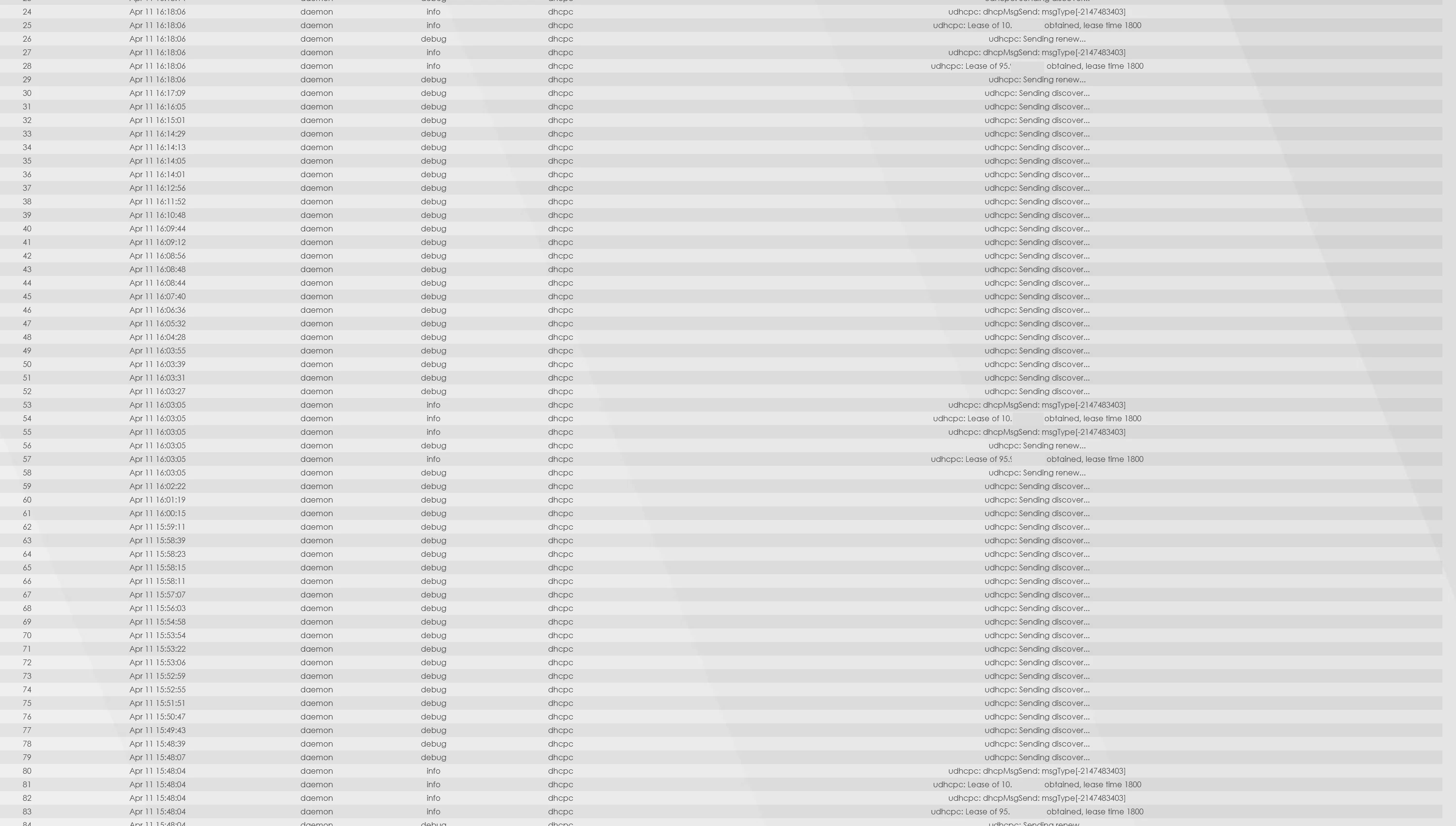

From the router logs I consistently see that the WAN interface keeps sending “udhcpc: Sending discover...”. Occasionally it briefly obtains a DHCP lease (for example 95.x.x.x and 10.x.x.x with a lease time of 1800 seconds), but immediately after that it falls back into sending discover again. This cycle repeats continuously, roughly every 10–15 minutes.

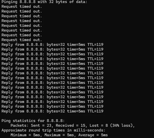

I also ran ping tests to 8.8.8.8. When starting a ping, sometimes the first several packets time out, and only after that replies become stable (~5 ms). Overall there is noticeable packet loss.

I have a Zyxel-T56 too, the logs are full with sending discover but that isn't causing any problem with the connection.
