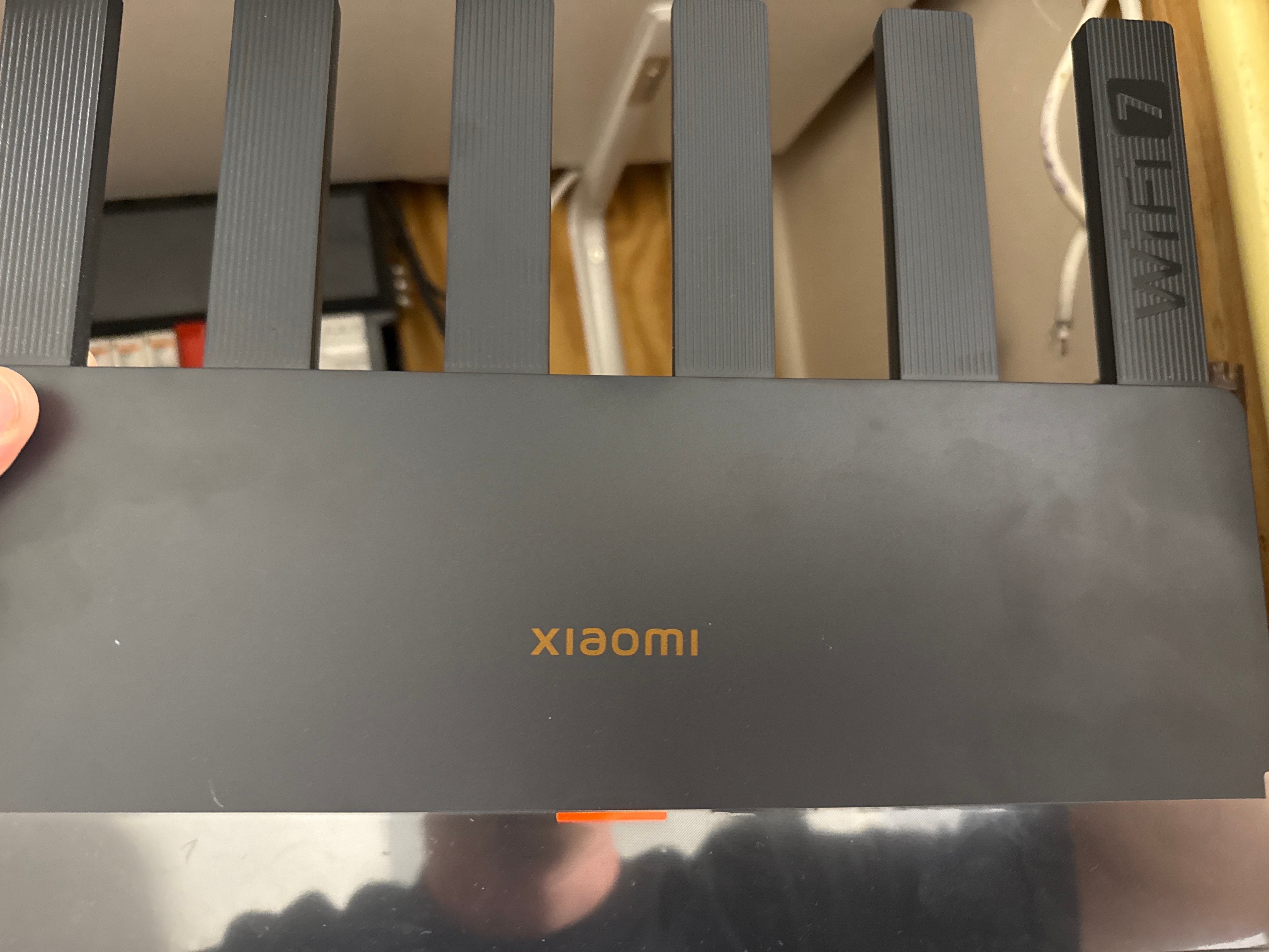

Hello everyone,
I could use a bit of help. I recently bought a new Xiaomi BE6500 router and I'm trying to connect it to my home internet.
Here’s the situation:
  • The internet connection works fine when I plug the cable directly into my computer.
  • But when I connect tit to the BE6500, the router doesn't seem to detect the internet connection at all.
Has anyone else run into this problem? Could there be a setting I need to change, or something I'm overlooking?
Thanks in advance for any help or suggestions!
