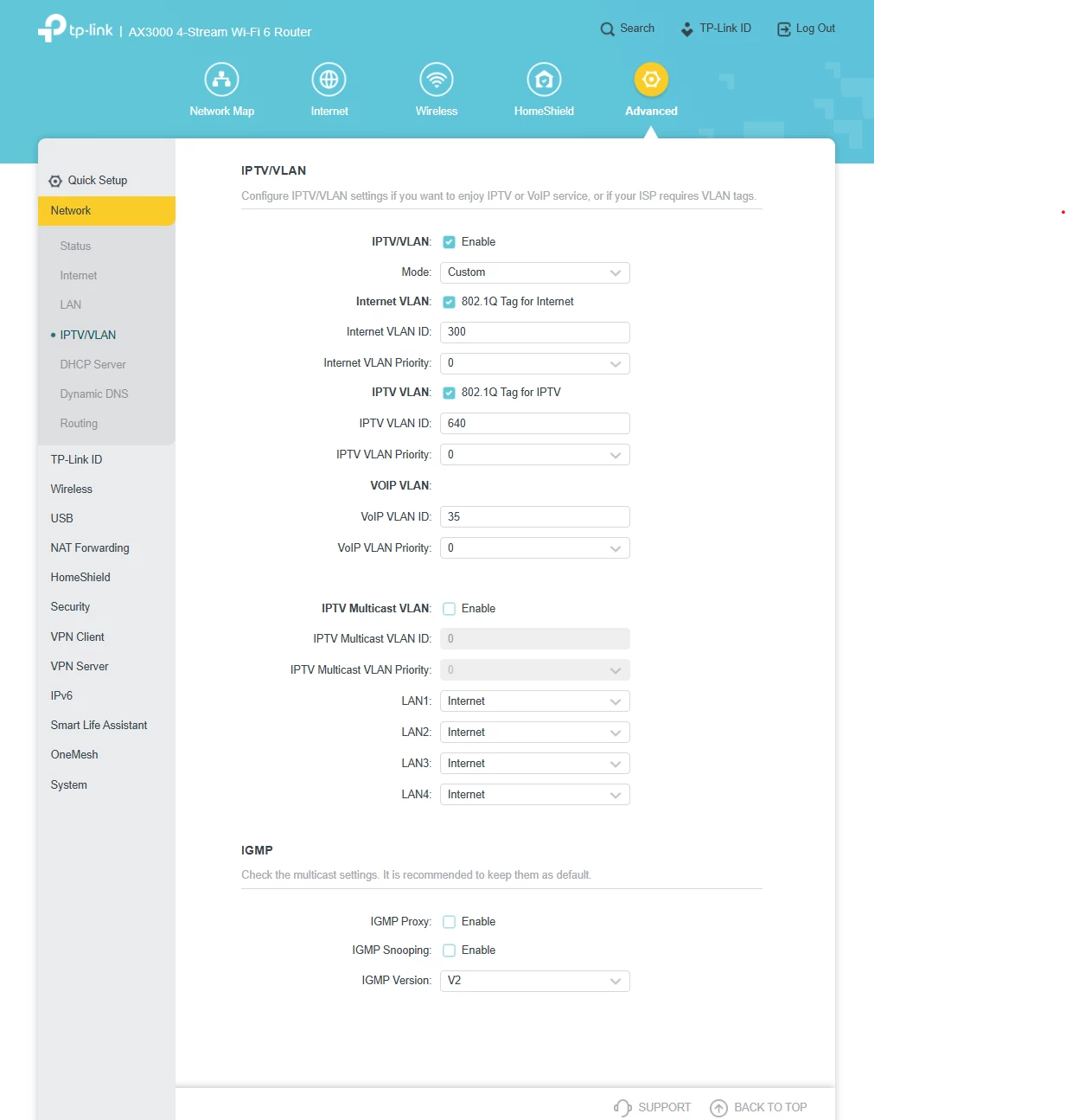

I’m trying to replace my Zyxel T-54 with TP-Link Archer AX55. I went over the other threads and found the required VLAN configuration (screenshot attached), but it still doesn’t work for me. I’ve tried factory reset, rebooting mediaconverter/router, different priorities in settings with no success.
I ended up connecting Archer to Zyxel in bridge mode as a workaround.
Is there anything else I can try? I have Odido Business if it’s relevant.

You can’t set a Zyxel T-54 in bridge mode as far as I know. Maybe you put the TP-Link in the DMZ of the Zyxel. Unless this is possible in the Business model (not sure about that).
I am sure the Business side of Odido is NOT on VLAN 300. They might be on VLAN 32 (or something else). You should contact the Business helpdesk to find out (this is the consumer side community).
Here is a PDF which might provide more info about connecting your own equipment:
https://assets.odido.nl/x/75c886a314/20230905_dienstbeschrijving_zakelijk_internet.pdf
(It states that VLAN 32)
