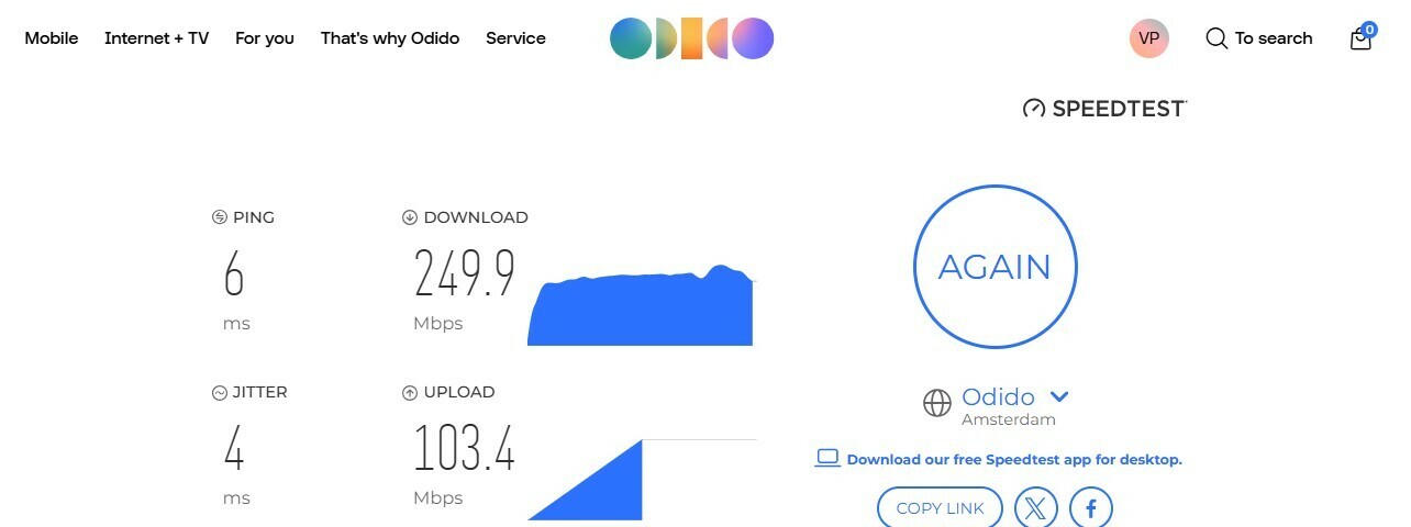

I have a 1 Gbit/s up en down subscription, but when I do a speed test all I get is 250 Mbps Download speed and 104 Mbps upload speed, which is not even half of the subscribed speed. For background, I live in a apartment and use ZYXEL T-56 (firmware : V5.70(ACEA.0)T56C_b10_0130). It was fine all these days and from couple of days I see sudden drop down in the internet speed and the streaming content started buffering. I was having 400Mbps subscription in the beginning and yesterday I upgraded my plan to 1Gbps, even the issue is same. Below I attached the snap of speedtest captured around 17:15 CET on 8th May 2025. Can someone from Odido look into the issue and fix ASAP?

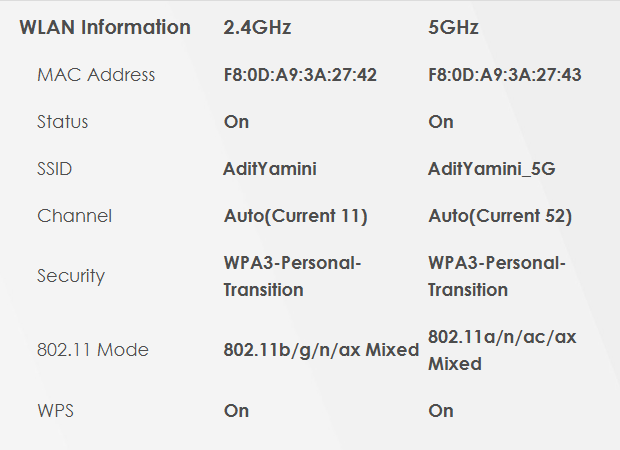

You can also log in on to router, go to the menu, netwerkinstellingen, draadloos, kanaalstatus, select 5 GHz en click on scan.
True. But that will only show the AP count on those channels. Not the actual strength of each AP. It’s not a problem to choose a channel where there are 4 other AP’s with much much less strength (you will just push those away). You want to avoid the channels where there are other string AP’s (i.e. the Neighbors).
BTW. The Auto-scan should pick the best channel for that moment.
I think if you want more speed, you might be better off choosing a wider band (40 or 80Mhz). But ultimately… a meter-cupboard is never a good place to place a router. Place it just outside, high against the wall besides the cupboard. (You can begin testing this by opening the door of the cupboard wide open)

Thanks for you response ​@rvk01. Yes keeping the modem outside cast is definitely having good effect, but unfortunately I am in a rented place and I dont have any other spot to place the modem and am not allowed to put nails in the wall. So for now it has to be in the meter cast (may be I will keep it outside when I have my own house😂.
But for now I installed WiFi Analyzer in my Windows laptop and it showed the better channel as 36 (with a star mark, I believe its indication for better channel strength).

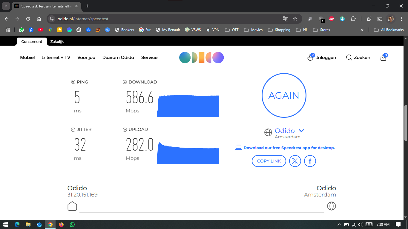

Hey ​@Waqqas, Thanks for responding, below is the Odido speedtest result while my laptop connected to router via LAN cable

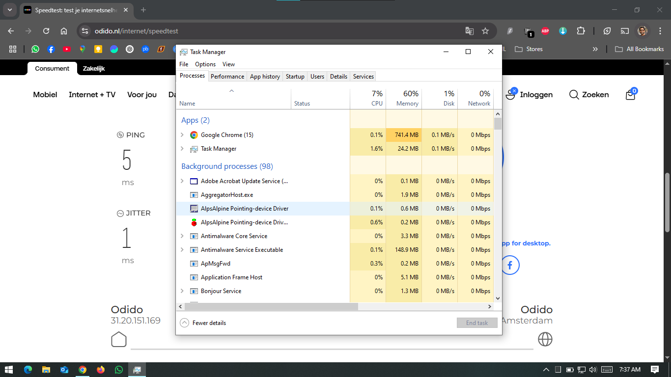

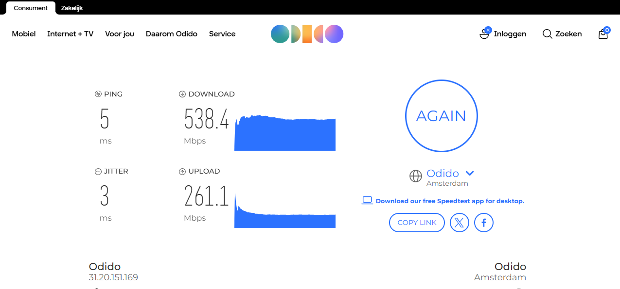

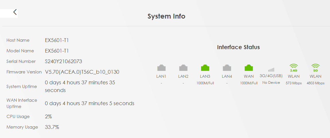

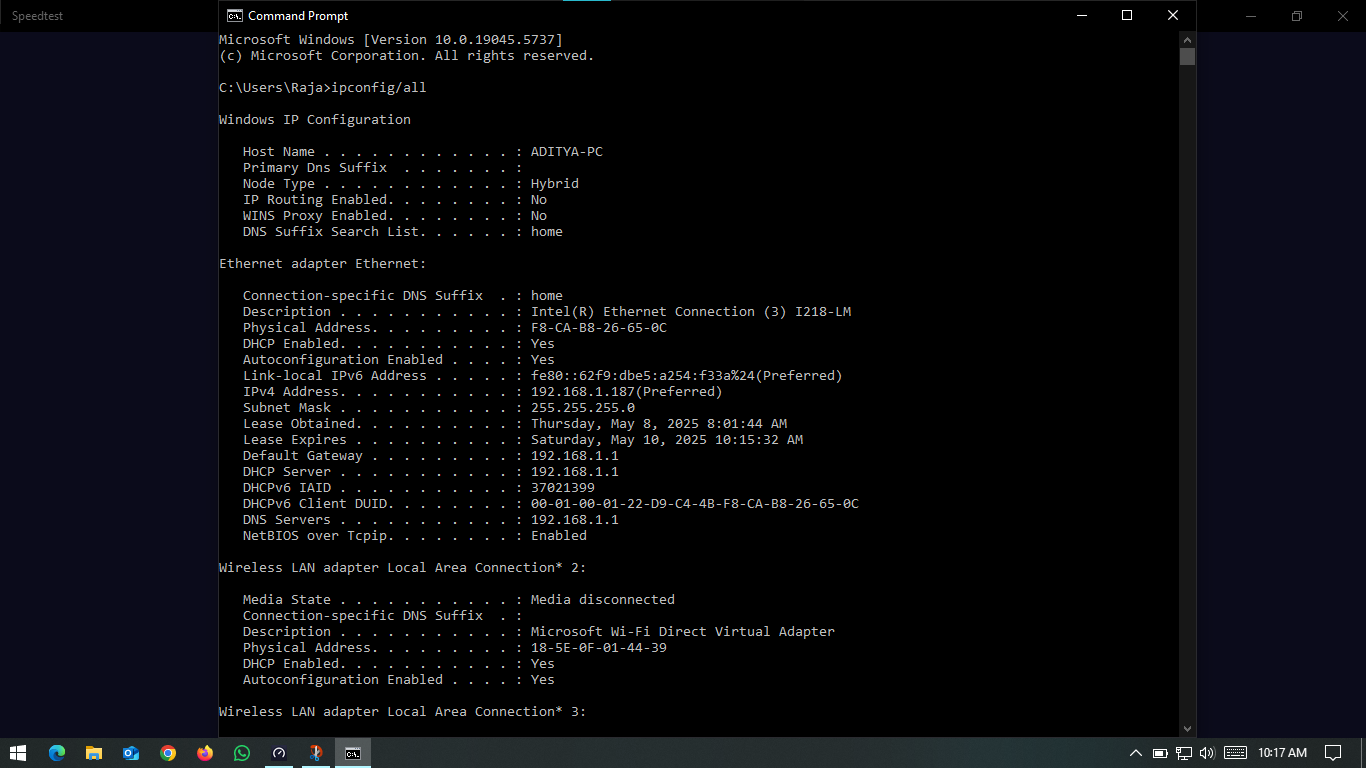

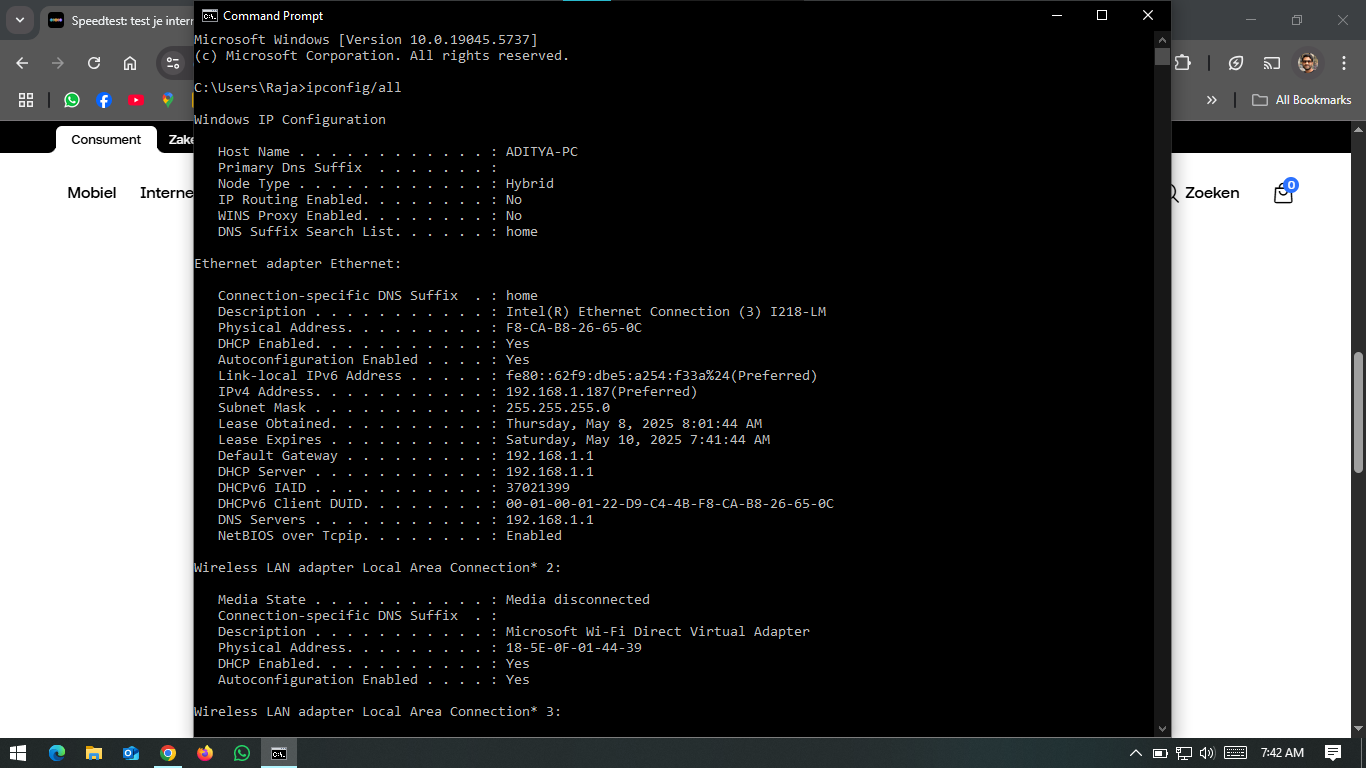

Hey ​@Waqqas, Below are the screenshots of the steps
This this while LAN cable connected:
This is the speed test on WiFi 5Ghz channel while standing next to the router

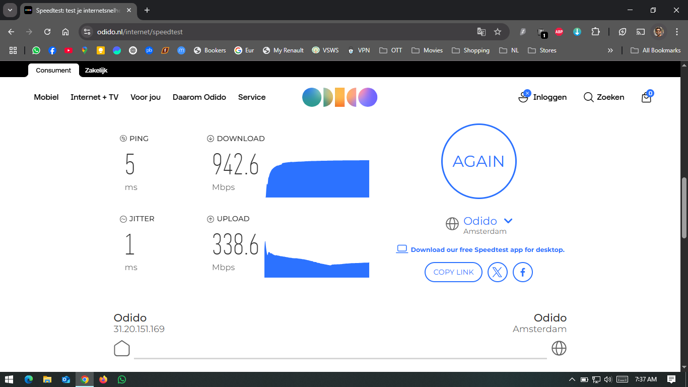

  • mei 9, 2025 8:03 a.m. UTC
​@Aditya P

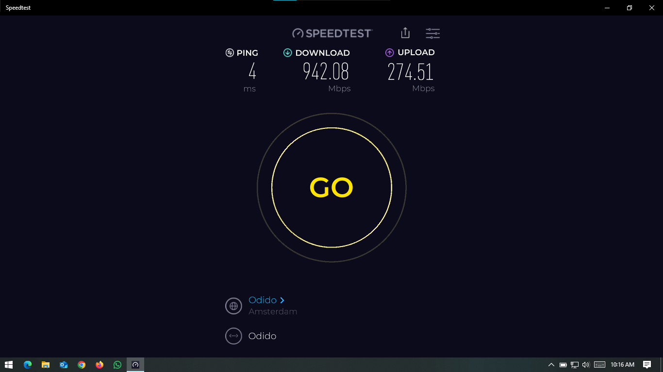

Please go to speedtest.net, dównload the app and perform anspeedtest via that app.
Aditya P
  • mei 9, 2025 8:20 a.m. UTC
​@Aditya P
  • mei 9, 2025 10:01 a.m. UTC
​@Aditya P
The download is ok and have you tried the following?
What you could also try is replace the cable between router and laptop, replace the cable between mediaconverter and router and restart the mediaconverter.

Yes I did, tried with different cables. My problem is not with wired connection but with wireless connection. I hardly connect any device to wired network at home. Wireless speed of wifi is 500Mbs if I am standing next to modem and it drops to 300 Mbps if I move 3 meters away from modem.

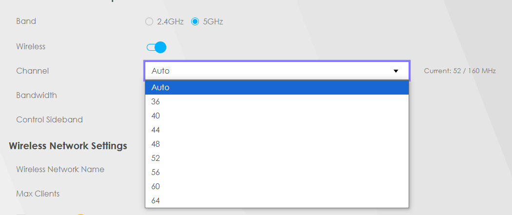

​@Aditya P
After you log in to the web interface, go to the menu, netwerkinstellingen, draadloos, algemeen, select 5 GHz and there you can try to use a fixed channel.
Aditya P
  • mei 9, 2025 11:24 a.m. UTC
​@Aditya P
I have this list of channels, so what you are suggesting is to set a single channel (ex: 48)? Does that improve the wifi speed?
  • mei 9, 2025 11:44 a.m. UTC
​@Aditya P
Maybe, install a WiFi analyser app on your phone and check which channel is not being used by neighbours.

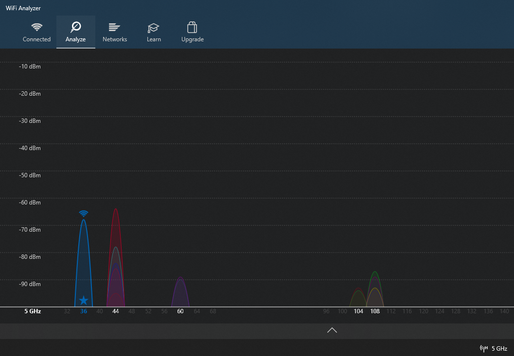

I have a iPhone. I did tried couple of apps, but none of them showed details about traffic on channels. Or may be I am too dumb to understand. Can you share a screenshot from any app showing channel traffic if you have it handy?
  • mei 9, 2025 1:53 p.m. UTC
​@Aditya P I don’t think Apple allows wifi scanner on iOS (yes, blame Apple for that).
But you said you also have a laptop. Is that a Windows laptop? You can use a wifi analyzer on that one. https://apps.microsoft.com/detail/9nblggh33n0n
  • mei 9, 2025 2:04 p.m. UTC
