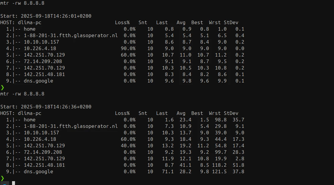

 Hi,
I did a factory reset, even turned of easy mesh to separate the bands.
I further changed the channel on 5G to the best (after using a wifi analyser).
I didn’t switch the cable since it runs through the wall, but the tests below confirm this is not the problem.
I ran the following command while standing right next to the router (so no physical interference).
The test at the top is using a LAN connection and the bottom one using wifi (5G)
 I further ran the following ping tests:
(ON WIFI)
ping -c 50 8.8.8.8
--- 8.8.8.8 ping statistics ---
50 packets transmitted, 50 received, 0% packet loss, time 49061ms
rtt min/avg/max/mdev = 10.024/22.156/106.442/22.395 ms
(ON LAN)
ping -c 50 8.8.8.8
50 packets transmitted, 50 received, 0% packet loss, time 49076ms
rtt min/avg/max/mdev = 9.576/9.761/10.074/0.125 ms
Based on these tests, the fiber line itself is stable (LAN latency ~9 ms, jitter <0.2 ms). However, the supplied router ZYXEL (EX5601-T1) shows significant instability on Wi-Fi, even when standing next to the device on the 5 GHz band (latency fluctuating between 10–106 ms, jitter ~22 ms). This suggests the issue lies with the router’s Wi-Fi performance rather than the ISP connection.
