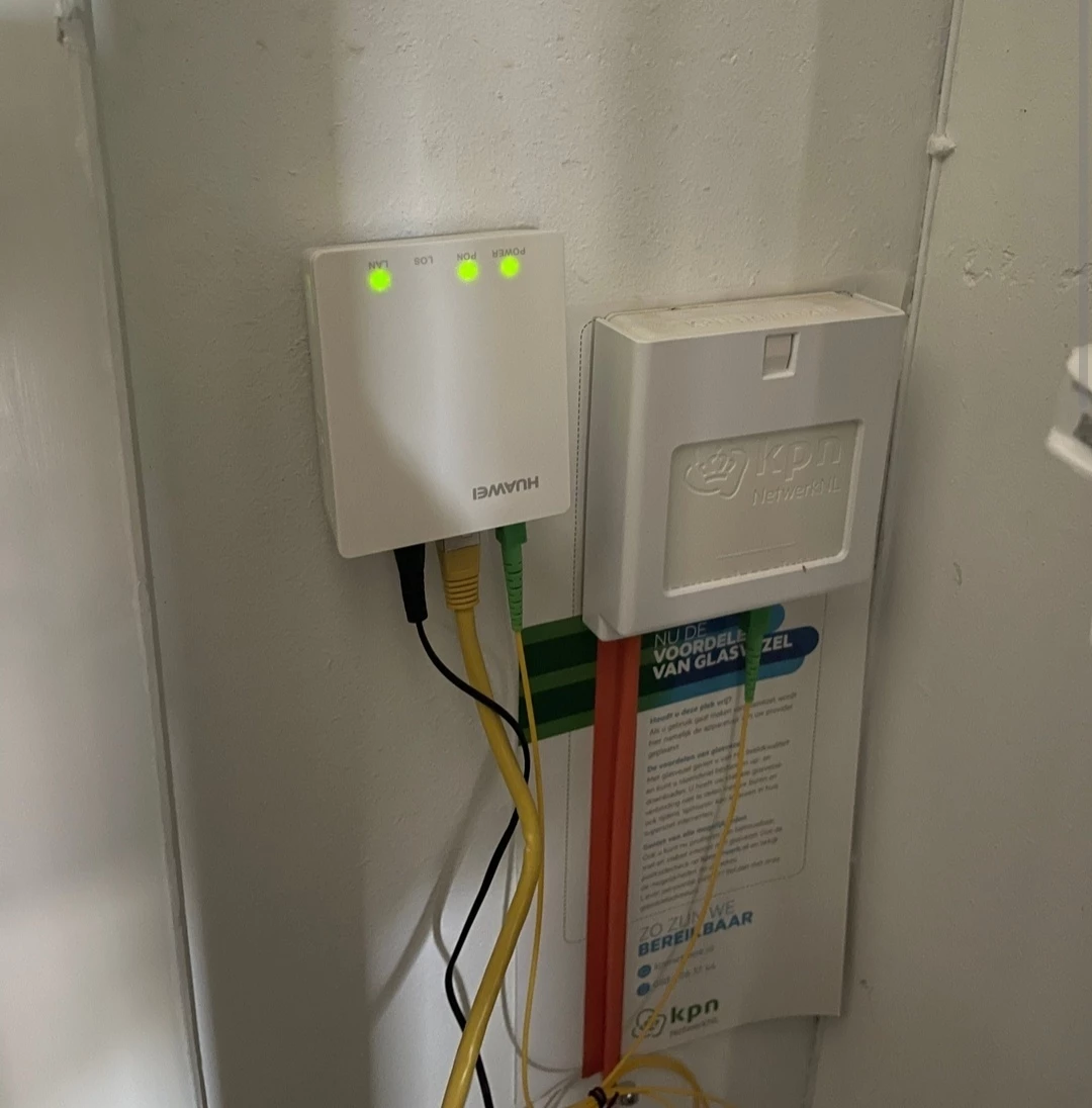

I see. How does fibre box looks like?

Something like the box on the right in the image below (the box on the left is the active ONT, kind of a modem, only present when you get an active fiber connection). The FTU (fiber termination box) is a passive box... A thin wire coming out of the ground going in that termination box.
