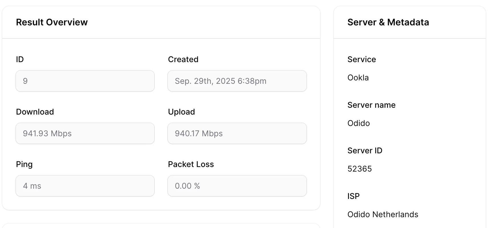

  • sep. 29, 2025 4:55 p.m. UTC
@Tommie van Odido Thank you for the help! I have confirmed it is working, I am synced, online, and getting the expected speeds:
Some feedback for others that might find it useful: I am using the Zaram ZXOS11NPI SFP+ module with a Mikrotik RB5009UG+S+ @ version 7.19.6 and it is working fine.
The Zaram incorrectly reports the SFP module as having a “Tx Fault”. This is not a problem and you can ignore it.
