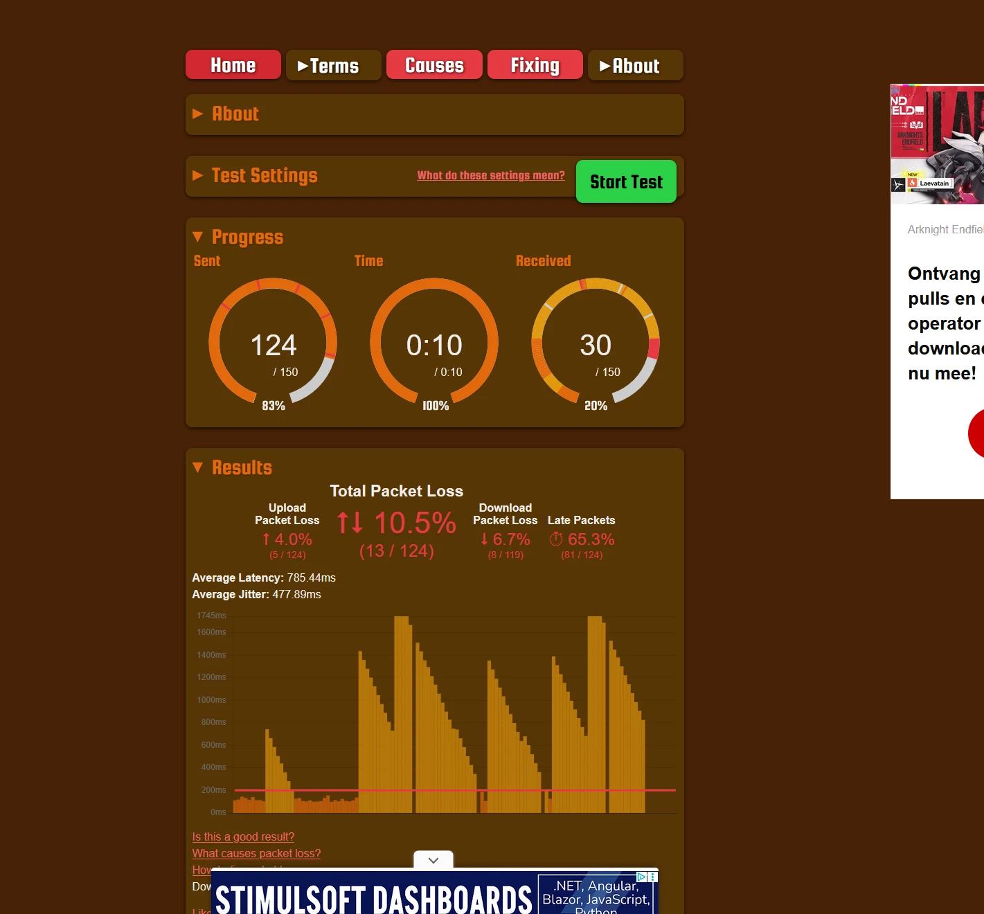

For the past two weeks my internet connection has become unusable for online gaming. I have frequent packet loss and jitter, which happens constantly throughout the day even at night (around 3 a.m.).
Speed and average ping are fine (ping stays around 20 - 40 ms), but the jitter and packet loss make gaming impossible. This issue did not exist before, or it happened very rarely.
Please investigate and resolve this problem. If it can’t be fixed, I will have to cancel my Odido service.

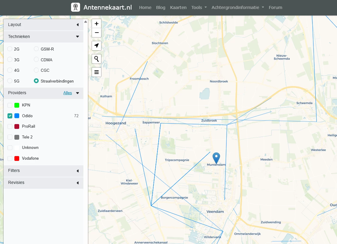

I see a lot of microwave links between the masts in your area on antennekaart.nl
If there is a bad link here you could have an issue. Perhaps call Odido support if they know of a network issue in your area.
