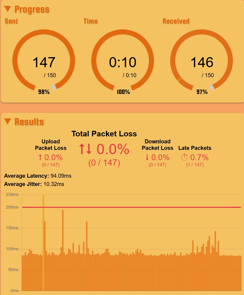

2. Packet loss test (packetlosstest.com, 10 sec)
  • Packet loss: 0%
  • Jitter: ~10 ms
  • Latency: ~94 ms

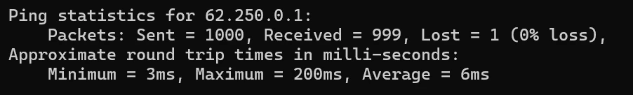

3. Ping-test 1000x naar provider gateway (62.250.0.1)
  • Gemiddelde ping: 6 ms
  • Minimum: 3 ms
  • Maximum: 200 ms
  • Packet loss: 0,1% (1/1000)

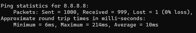

4. Ping-test 1000x naar Google DNS (8.8.8.8)
  • Gemiddelde ping: 10 ms
  • Minimum: 6 ms
  • Maximum: 214 ms
