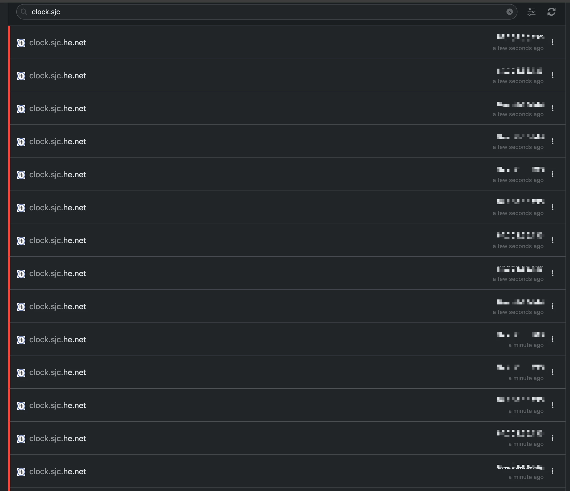

In my network (after having to isolate the devices one by one) the Zyxel WX5600-T0 (firmware V5.70(ACDW.0)b13, a beta build) is generating excessive NTP queries to clock.sjc.he.net, roughly 7-8 times per minute continuously. Neither device exposes NTP settings in the admin UI.
Is this a bug that needs a new firmware upgrade from Odido?
I cannot use ControlD as a DNS resolver basically as they blacklist my home IP as a compromised one 😢
