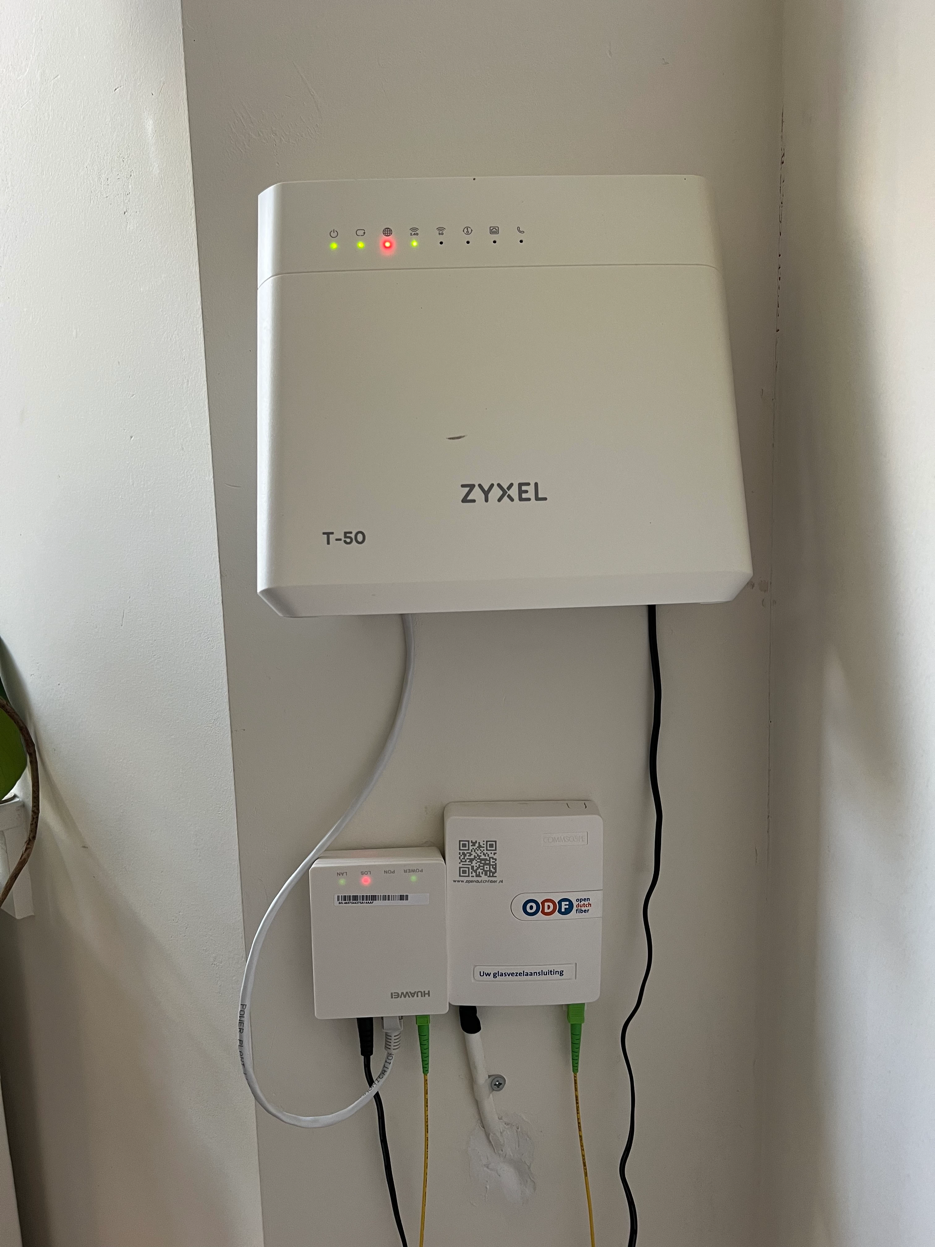

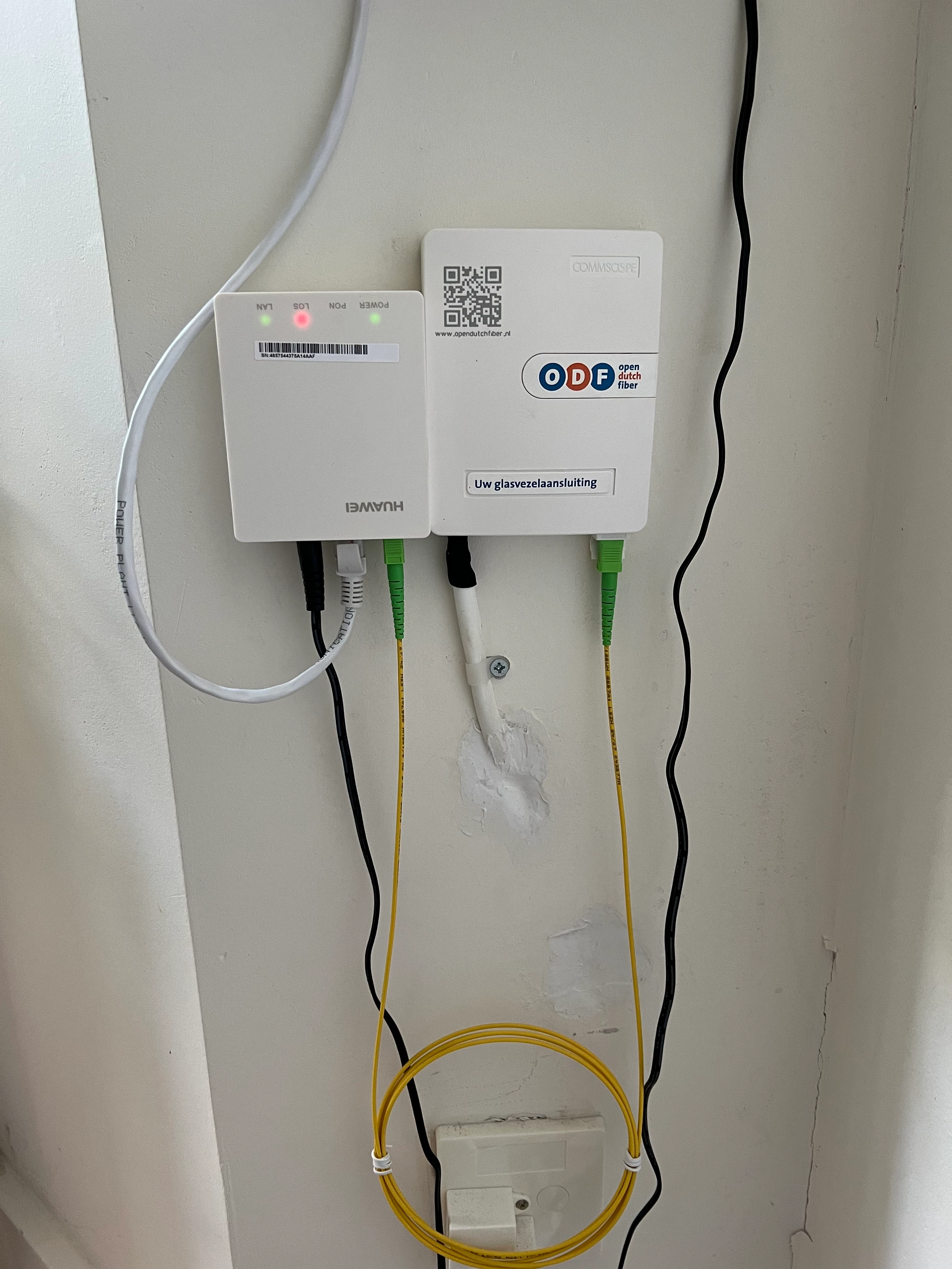

Hello ​@Tommie van Odido ​!
I keep the ONT and router switched on.
I performed a full power reset according to the steps you provided, but I still experience the same behavior.
  • PON light: off
  • LOS light: blinking red
I've attached images of my setup to this message.
So what are the next steps?
Thanks for the vouchers.
