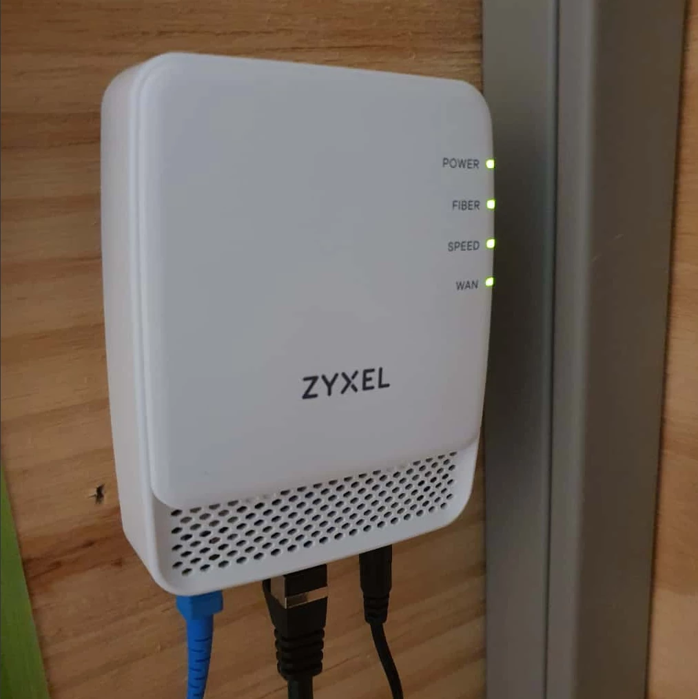

  • okt 9, 2025 9:49 a.m. UTC
Media converter
  • okt 9, 2025 9:58 a.m. UTC
Hello ​@UnhappyUser
That's indeed AON, the settings in my previous post should work. You can share a photo of the settings in your router interface and also a photo of the SFP.

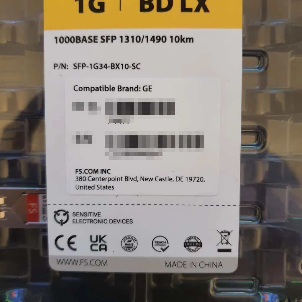

  • okt 9, 2025 11:18 a.m. UTC
SFP box
SFP
when using Odido media convert with an RJ45 SFP in the same port it works fine (at old place worked fine with gpon as well as XGSPON later when I upgraded)

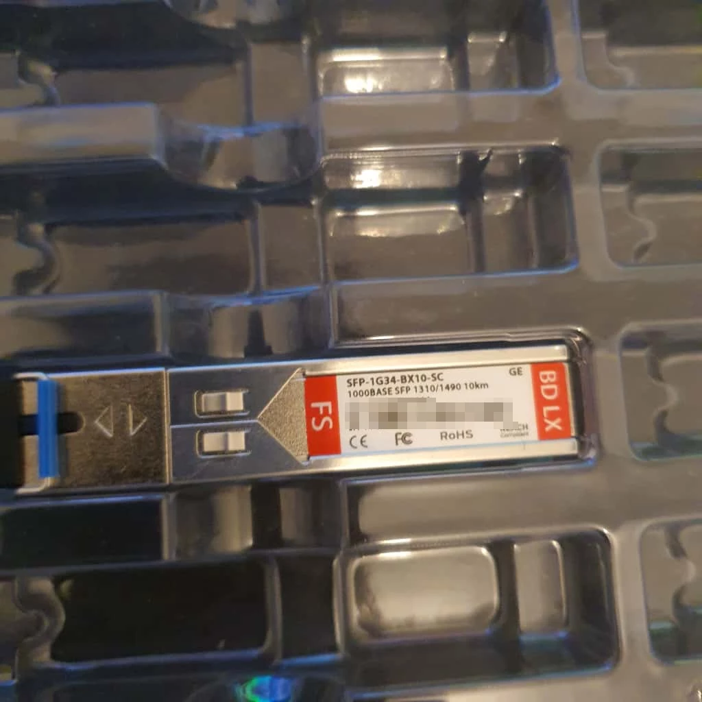

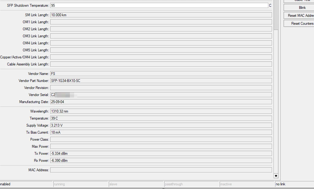

  • okt 9, 2025 11:29 a.m. UTC
SFP no link
  • okt 9, 2025 12:44 p.m. UTC
​@UnhappyUser
In another topic I can see that your SFP has the wrong wavelengths, you'll need this one.
https://www.fs.com/eu-en/products/39135.html
  • okt 9, 2025 12:48 p.m. UTC
Are you sure, in my notes I have Zyxel FMG3005-R20A (TX 1310 nm / RX 1490 nm) any way to quickly confirm before I order the other version ?

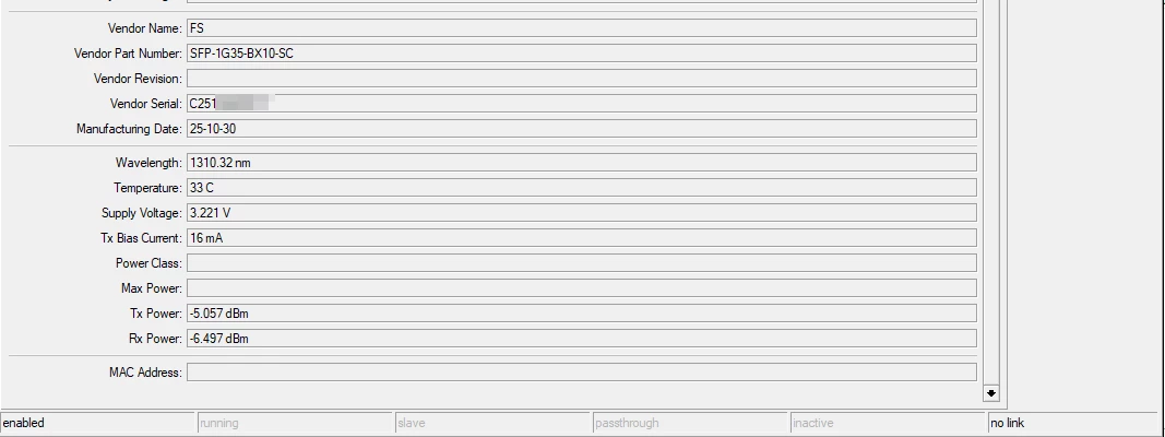

  • okt 9, 2025 1:13 p.m. UTC
  • okt 29, 2025 12:09 p.m. UTC
​@UnhappyUser did it work for you? I tried the FS module with the right wave lengths (1310/1550) and it didn't work. It only works when using the media converter.

Hi ​@Sven-Odido. I did get the right module with the correct specs, but it still didn't work. I shared as much technical information as possible in my topic, but didn't get a response. Perhaps you can help?
  • nov 10, 2025 5:12 p.m. UTC
​@Waqqas I have since purchased the one you mentioned /linked and again no luck.
