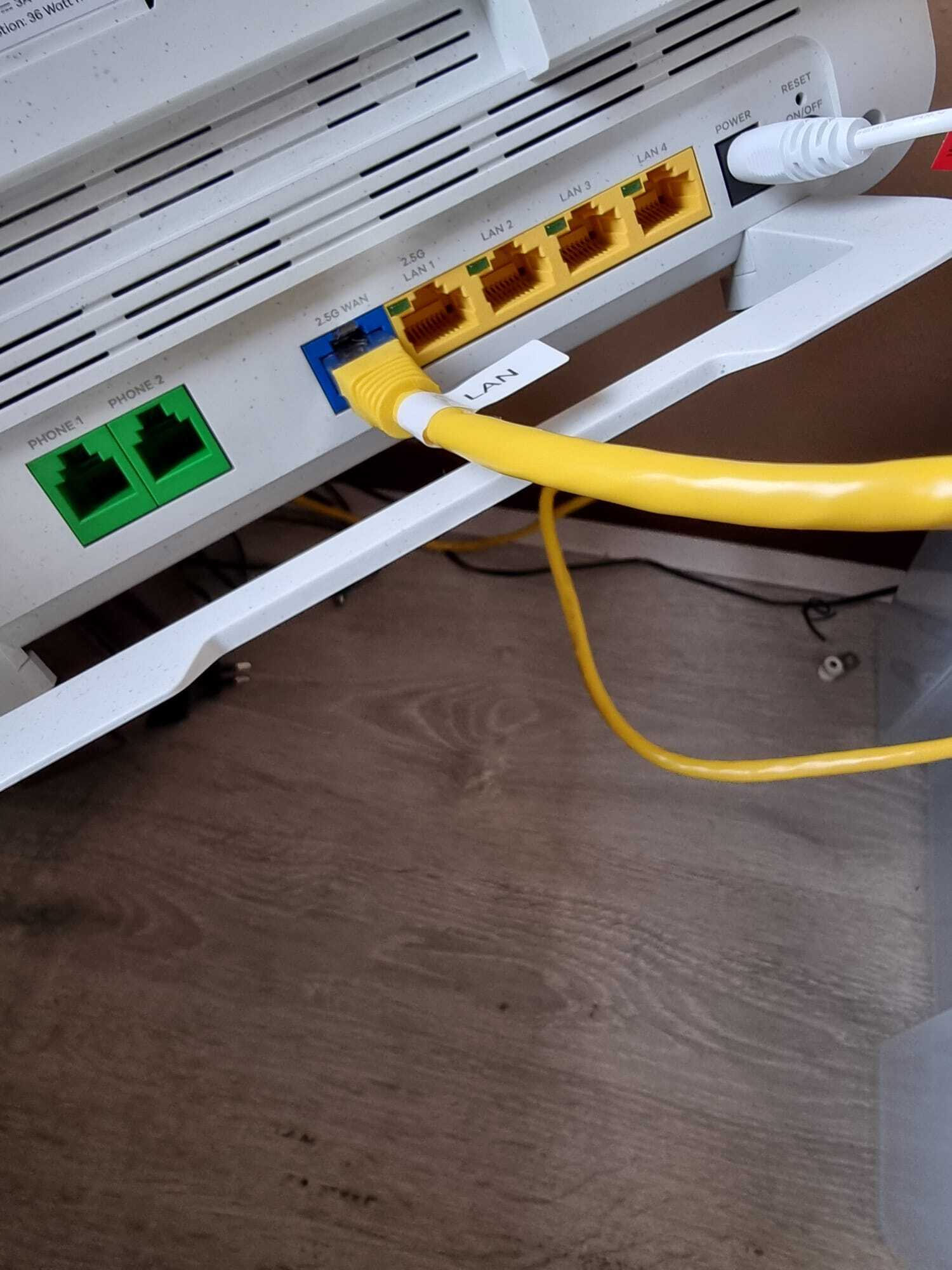

Hi, my internet stopped working after I turned off converter and router because of days of bad signal and low speed. Not it simple does not light up the LAN 10G led on the Huawei ONT/Fiber converter. I tested other modem and the cables are working fine, the problem seens to be the ethernet jack connector from the Huawei Fiber Converter.

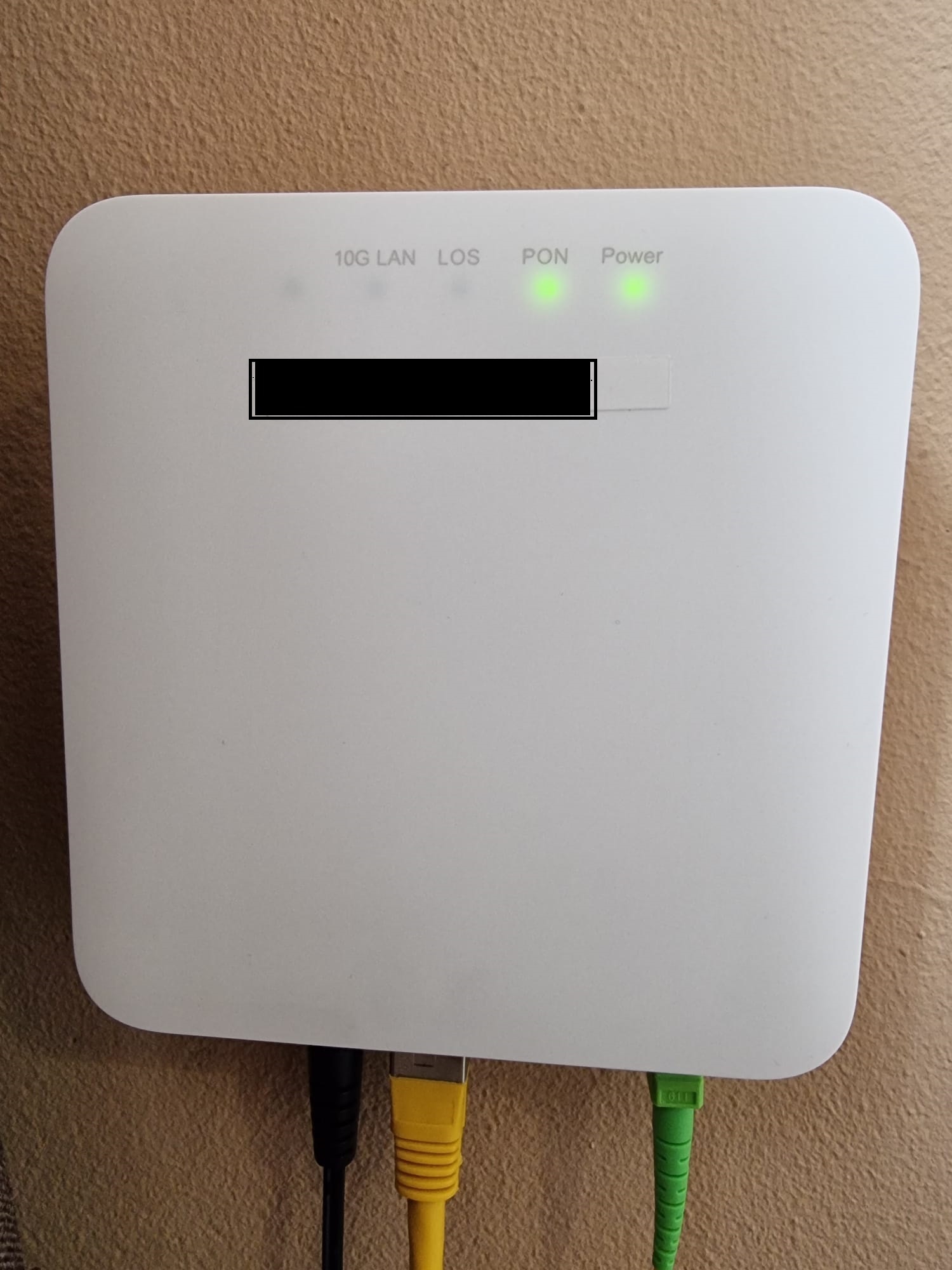

Power brandt constant (er is dus power), PON brandt constant (verbinding tussen ONT en upper-later device), LOS lampje is uit, 10G LAN lampje is uit.
  • apr 21, 2025 1:05 p.m. UTC
Hier is een foto:

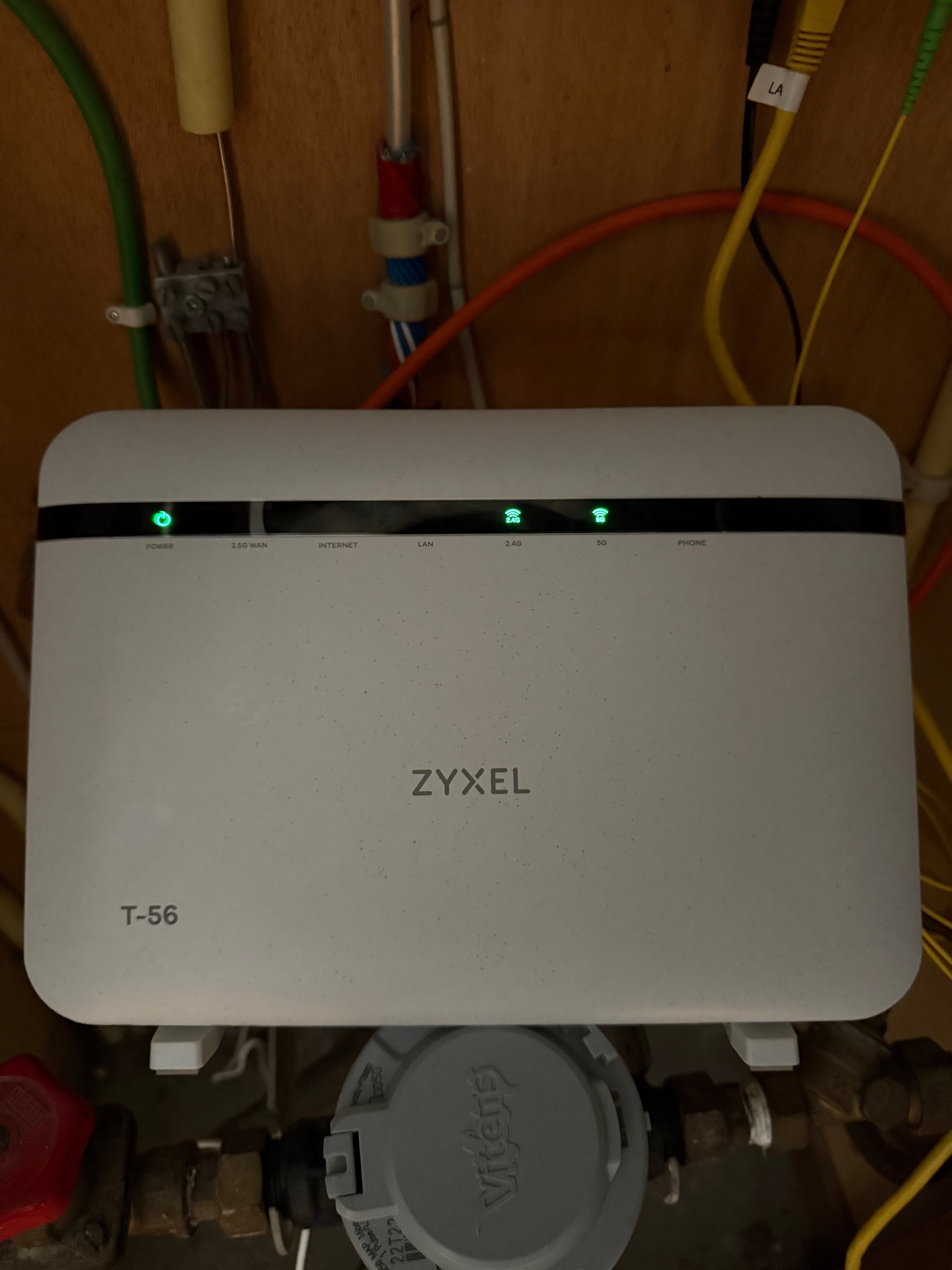

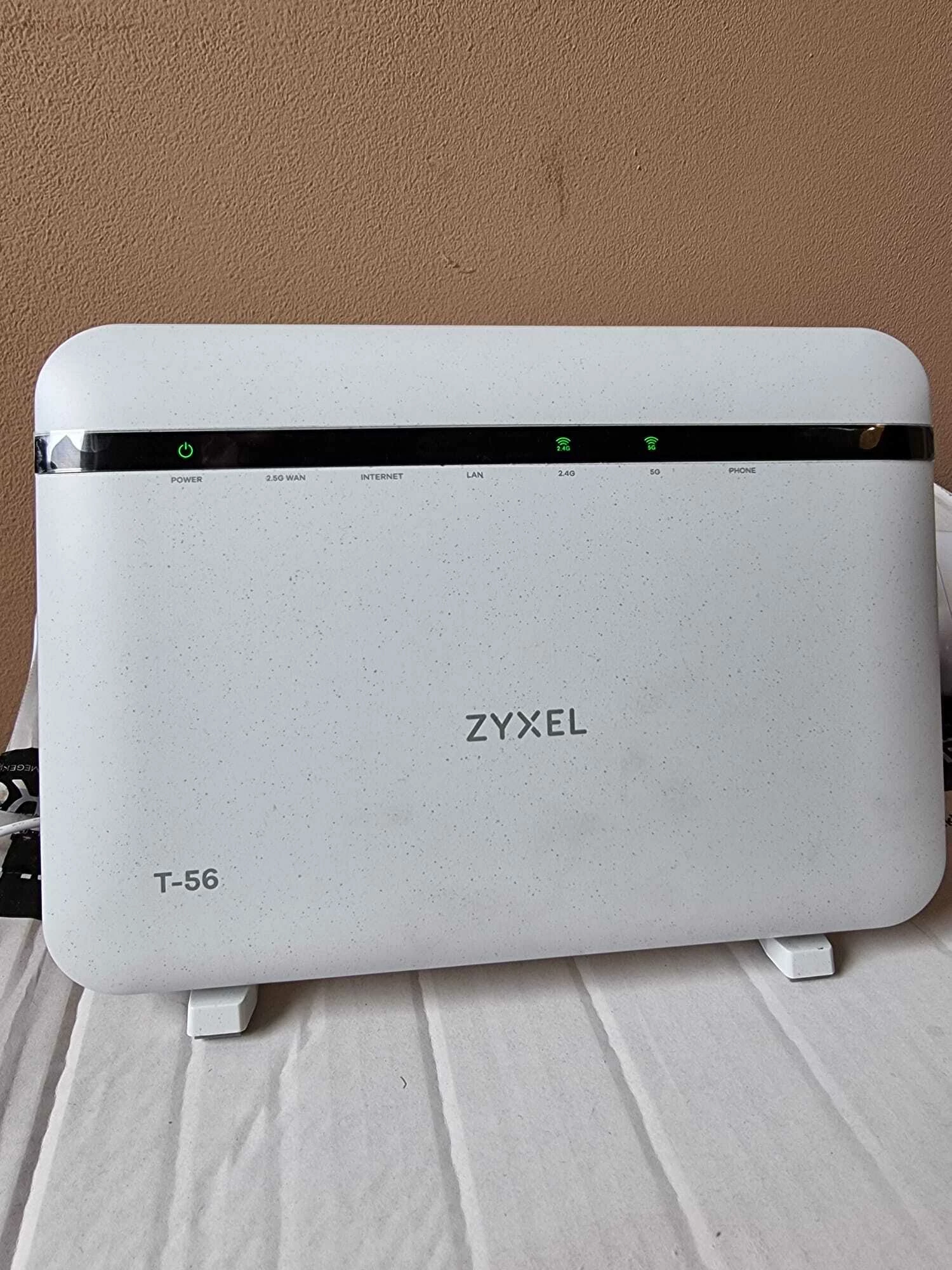

Hier nog een foto van de Zyxel T-56 router. Je ziet dat er power is, dat de 2.4G en 5G Wifi in de lucht is maar er dus geen WAN en Internet is (ik heb geen telefoondiensten)

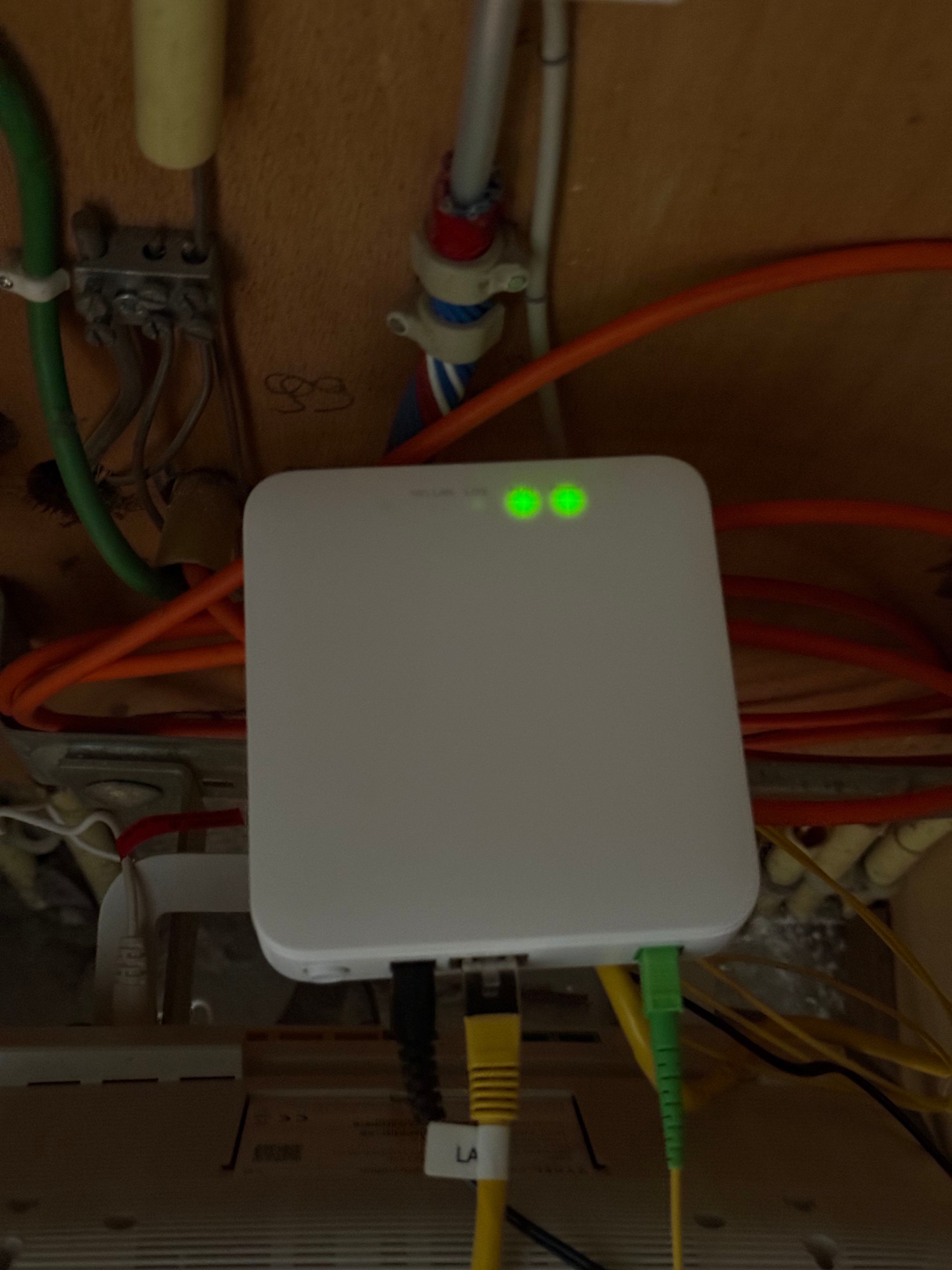

I have exatctly the same problem as Morris. It started yesterday without youtube loading videos and I went to reset everything because the past week was very high latency and unstable connection. I decided to take off from the power cable and it never came back the internet after multiple and several attempts to reset, insert cables, change for another cables, and it is always the same.
I have tried to connect thru the ethernet cable with to the IP 192.168.100.1 to enter the ONT/Converter settings and see if there is signal from the fiber but I just cannot access it, when I try to ping my with windows terminal says it is unacessible or gives the message (ping transmit failed general failure). Therefore, I can access the router normaly with the ethernet or on wifi (without internet) and when doing the wizard set up it shows the graph that there no lan connection between ont and router (there is an X icon on the dashed lines).
Also, what made me believe the problem is the ethernet connector on the converter is because I have a second ONT from Huiawei that was previously used on this house by older tenants and this one I can access 192.168.100.1 setting my desktop ethernet adapter to 192.168.100.2 and msk 255.255.255.0, using the same ethernet cables and the LAN light turns on, but the PON blinks twice per second so I do not have authentication for the fiber on that ONT apparently.
The following pictures are the devices provided by ODIDO and installed by Guidion 7 months ago.
