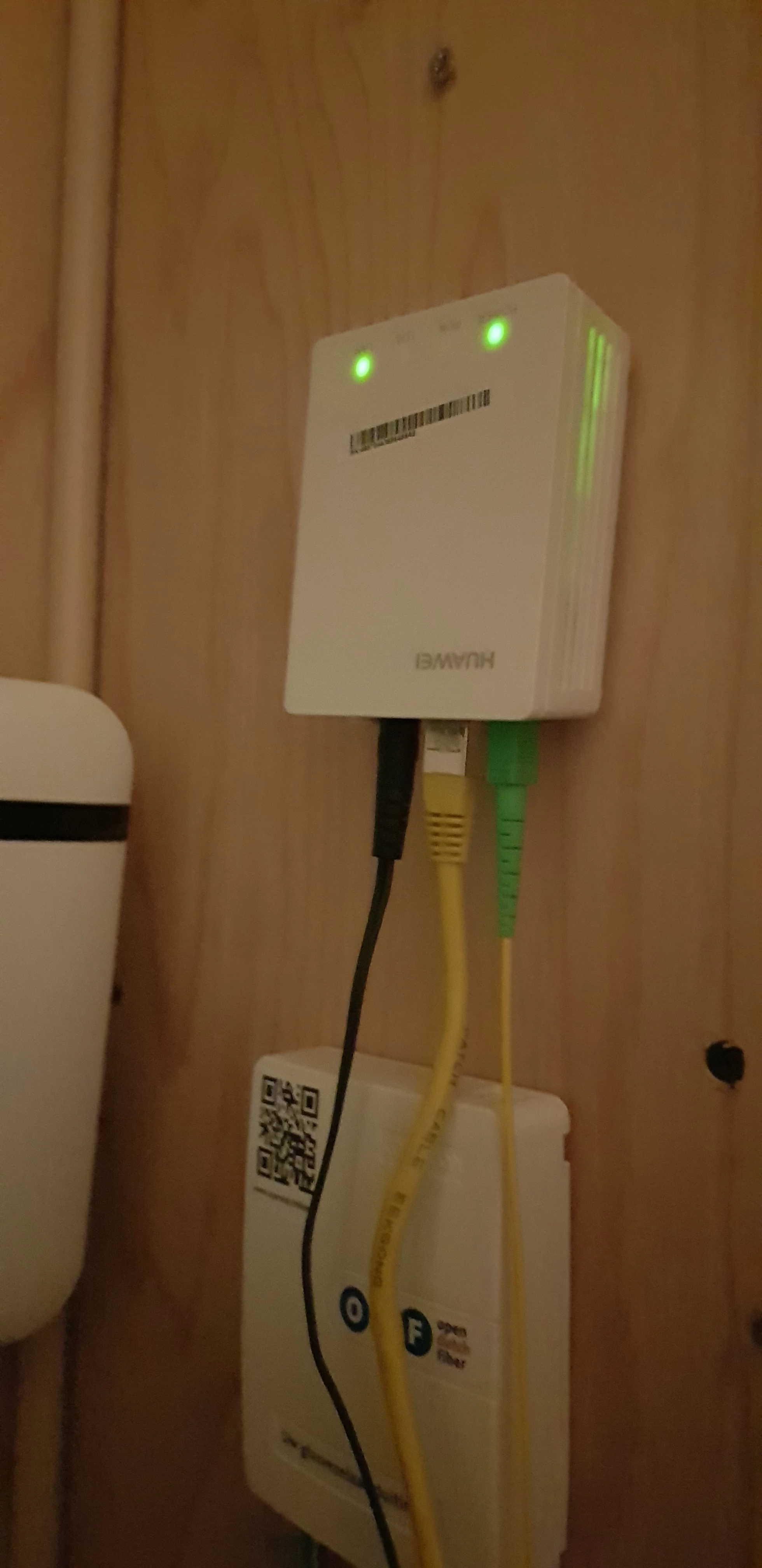

No Glasvezel internet since 12 Hrs. Location: Utrecht.
What should I do ?

Hi ​@Harsha, I would like to look further for a solution! For this I need some information:
  • Is the WAN light on the modem lit? (this is the light next to the power light)
  • Is the LOS light on the fiber optic box flashing? If so, is it flashing quickly (4 x p/sec) or is it flashing slowly (1 x p/sec)?
  • How is the PON light lit? Is it flashing quickly or slowly?
Thank you in advance! Greetings, Ishana

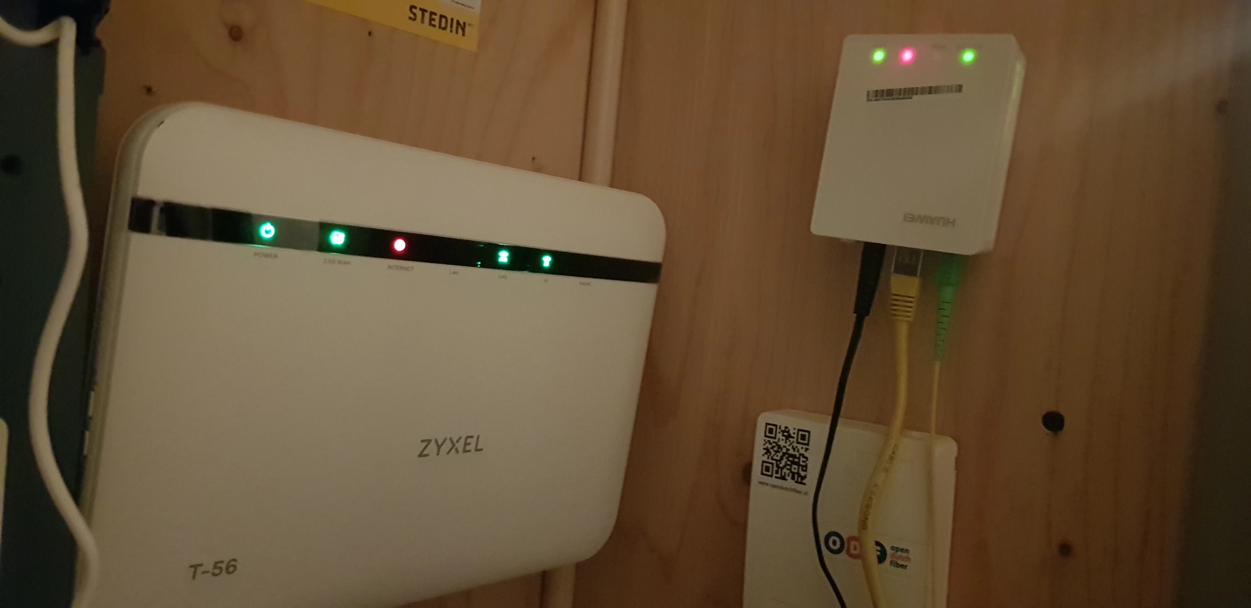

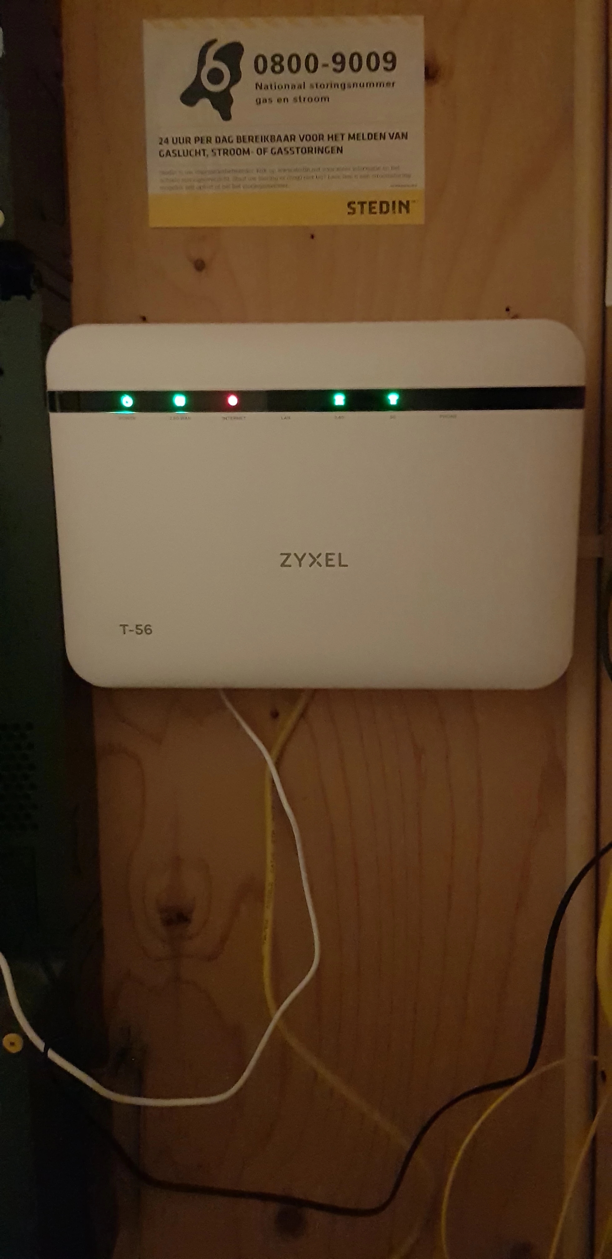

Hi ​@Ishana van Odido
See my response in bold text.
  • Is the WAN light on the modem lit? (this is the light next to the power light) - Yes
  • Is the LOS light on the fiber optic box flashing? If so, is it flashing quickly (4 x p/sec) or is it flashing slowly (1 x p/sec)? - Its flashing red (not seen in the Picture)
  • How is the PON light lit? Is it flashing quickly or slowly? - Its not lit.
  • jan 16, 2025 6:28 a.m. UTC
The situation remains unchanged. LOS is blinking red. PON is not lit.
