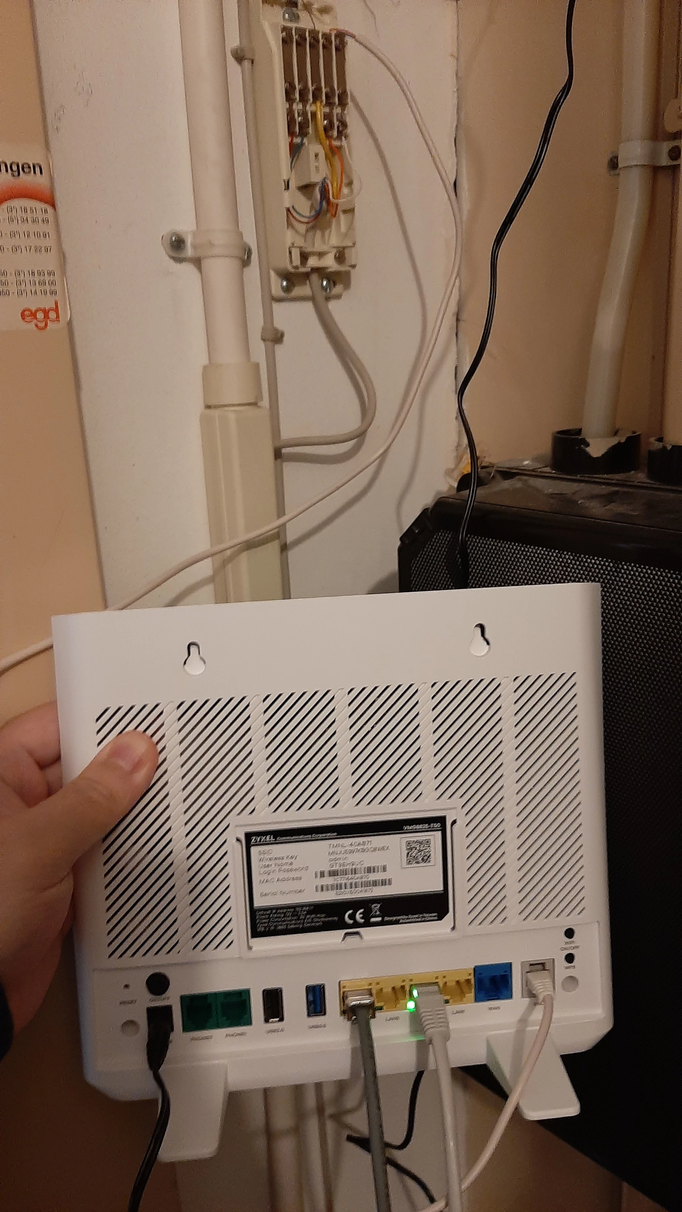

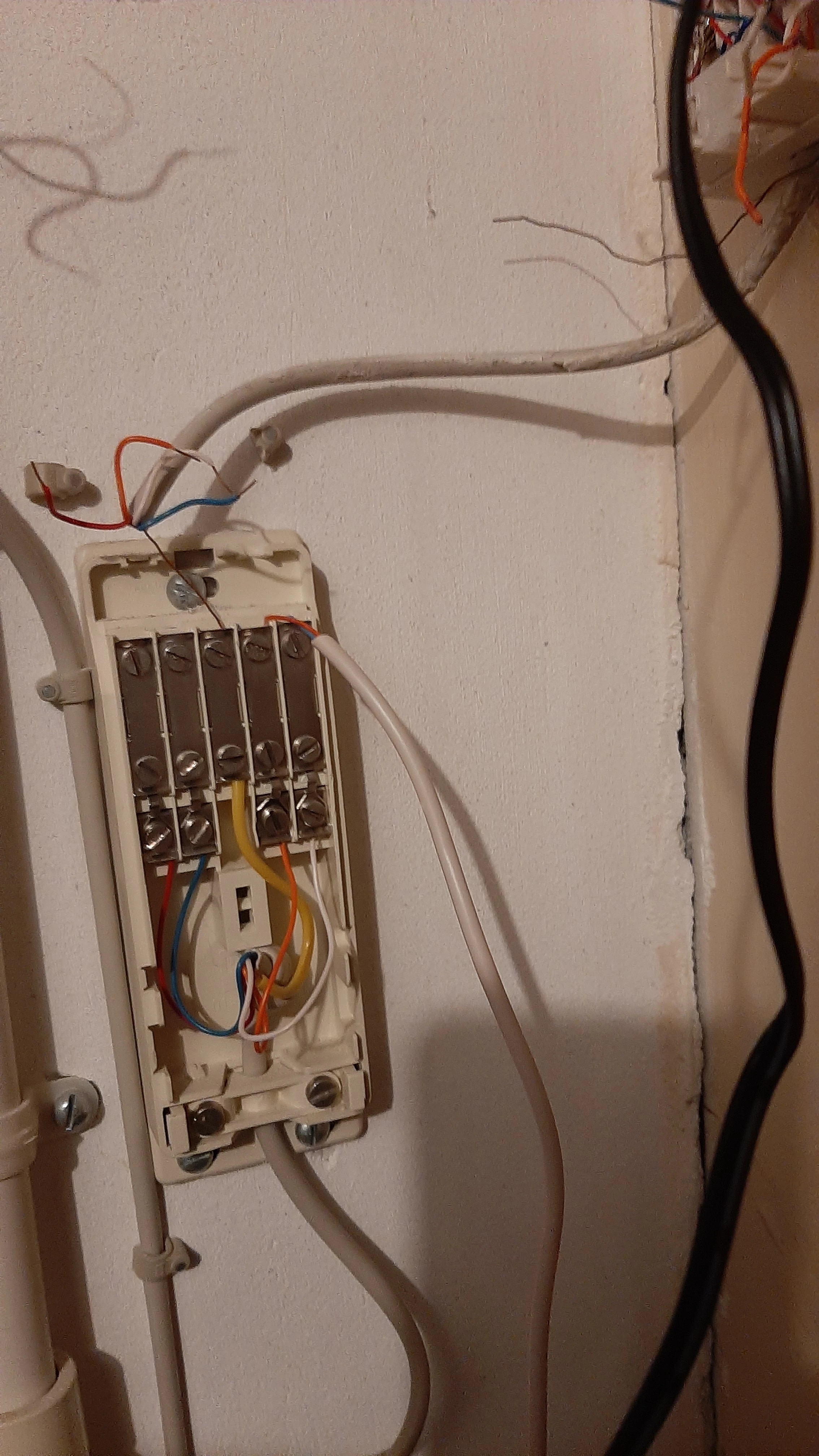

Looks like there is no signal. Is your modem connected to the main ISRA point where the KPN cable enters your house or is it connected via another connection point in your house?
Share a photo of how your modem is connected.

this is a photo from where the model is connected

and this is another photo.

​@mohammadimathstar
The cable with th red and blue wire goes directly into the DSL port of the modem?
You can also try to connect the cable on the left side, red on red and blue on blue.

yes, the cable goes directly to the DSL port.
As you said, I have connected the cable on the left side, but there is still no signal.

​@mohammadimathstar
Seems like an issue outside your house, well you can connect the cable on the right hand side again and wait for a moderator to reply.
