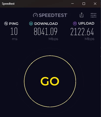

Hi there,
I recently activated an 8Gbps home internet plan. While the download speeds appear to be working as expected, the upload speed is consistently capped at 2 Gbps rather than 8 Gbps.
Could this indicate an issue with my speed profile or provisioning? All relevant account and service details should be available in my profile.
Thank you for your assistance.
Best regards,
ixl0: flags=1008843<UP,BROADCAST,RUNNING,SIMPLEX,MULTICAST,LOWER_UP> metric 0 mtu 1500
        description: ONT (opt11)
        options=4800028<VLAN_MTU,JUMBO_MTU,HWSTATS,MEXTPG>
        ether xx:xx:xx:xx:xx:xx
        groups: Interfaces
        media: Ethernet (10Gbase-LR <full-duplex>)
        status: active
        nd6 options=29<PERFORMNUD,IFDISABLED,AUTO_LINKLOCAL>
        drivername: ixl0
        plugged: SFP/SFP+/SFP28 10G Base-LR (SC)
        vendor: FS PN: XGS-ONU-25-20NI SN: xxxxxxxxxxxx DATE: 2025-03-13
        module temperature: 43.00 C voltage: 3.48 Volts
        lane 1: RX power: 0.03 mW (-14.88 dBm) TX bias: 16.32 mA

Hello ​@farox
Was the upload good when you were using the Zyxel router?
Otherwise you will have to install the Odido equipment again so Odido can check this for you.

On what hardware are your running.
(If it’s a UDM, it could also be due to Smart Queues/QoS or IDS/IPS settings)
farox
  • dec 24, 2025 12:22 p.m. UTC
No Ubiquiti here—just OPNsense running on my own hardware. No IPS enabled; it’s a direct connection to the internet.
What caught my attention was the ~8 Gbps download speed and how precisely the upload is capped at 2 Gbps.
farox
  • dec 24, 2025 12:24 p.m. UTC
LAN-to-LAN is 10 Gbps in both directions with no issues, which makes me suspect something on Odido’s side.
  • dec 24, 2025 12:37 p.m. UTC
Hello ​@farox
