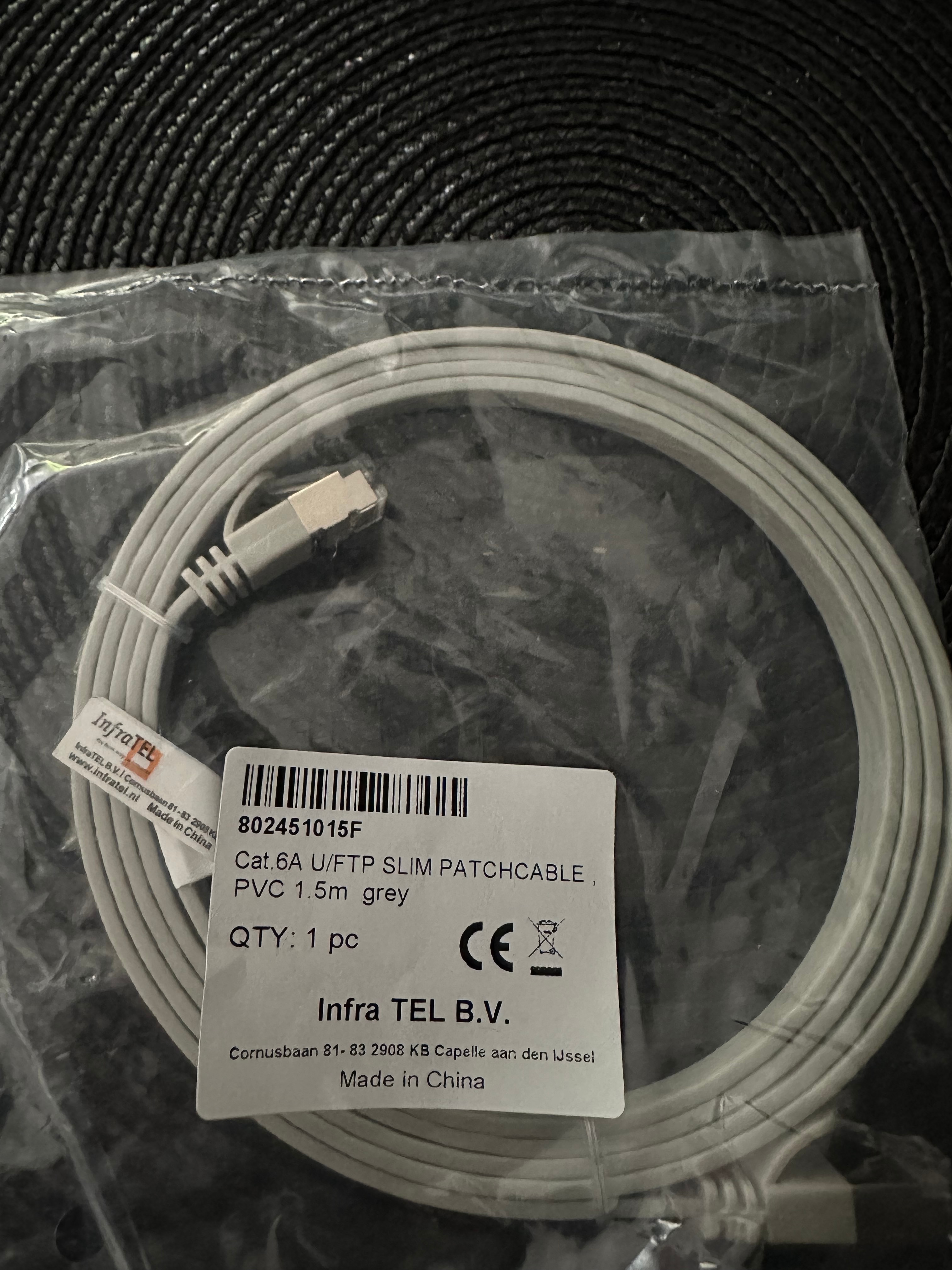

The cable between ONT and router is ok. Which iPhone do you have?

@piotrowski
The cable between ONT and router is fine, which phone do you have?

I have this cable and my phone is iPhone 14 Pro

The cable and router are new so everything should work fine, but the connection is weak for 2 GB, don't you think?
