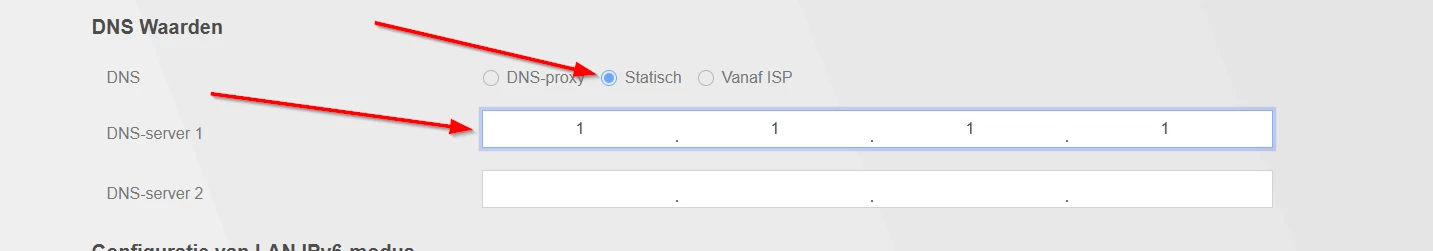

You can change it in your computer or phone itself or change it in the router. When changing it in the router, that DNS server will be served to the clients when they reestablish contact. Just say what you prefer and we can guide you. (in the router it is on 192.168.1.1, login on the back, and then under three lines, upper right, netwerinstellingen, thuisnetwerk, statisch dns and then the value).
  • dec. 20, 2025 3:41 p.m. UTC
Hello ​@nikol
To change the DNS servers log in on the router interface. In the menu go to netwerkinstellingen, thuisnetwerk, LAN configuratie, under DNS waarden choose statische DNS and enter 8.8.8.8 and 8.8.4.4 and click on toepassen.
Restart your router after this.
Router restart is not needed (because these are settings sent to the client, not used in the router).
You do need to reconnect the clients to the router (so restart all the clients).
(If you don’t restart the clients, they keep the lease, even if the router briefly restarted, and these changes are not directly done.)
