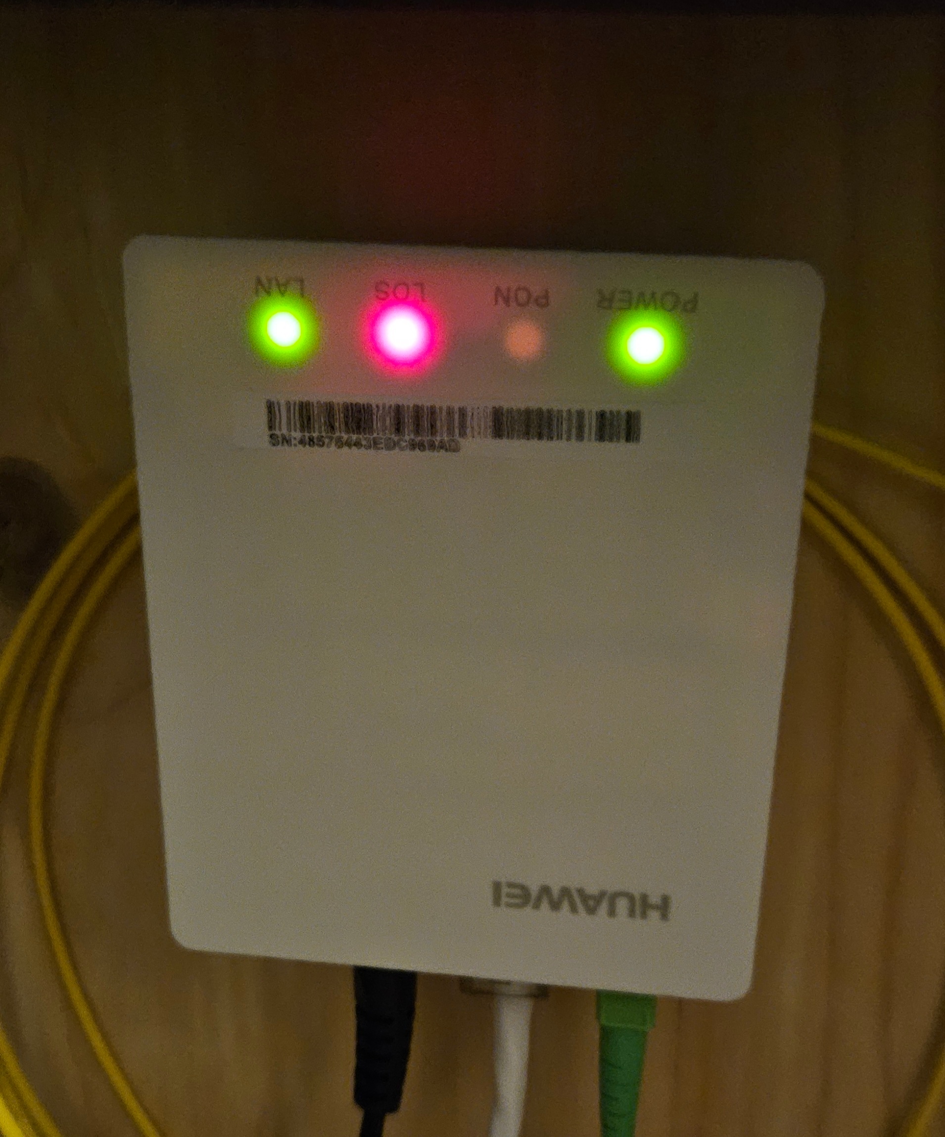

Hi, I’m experiencing the same issue mentioned above with my Huawei converter—the LOS light is blinking red. I’ve tried rebooting several times, but nothing seems to work. I’ve had no internet or TV since Tuesday. Could you please help?
Ishana van Odido
Forum|alt.badge.img+4
  • 2211 reacties
  • 25 januari 2025
Hi ​@Laurynas, I have done some measurements for you right away! I am not getting a full connection with your modem. I would like to look further for a solution! For this I need some information:
-Is the WAN light on the modem lit? (this is the light next to the power light)
-Is the LOS light on the fiber optic box flashing? If so, is it flashing quickly (4 x p/sec) or is it flashing slowly (1 x p/sec)?
-How is the PON light lit? Is it flashing quickly or slowly?
Thank you in advance! Greetings, Ishana
  • 2 reacties
  • 25 januari 2025
Yes it’s on and green.  Los light on converter 1 time per second. Pon light does not flash at all, it’s off
Nora van Odido
  • 1596 reacties
  • 26 januari 2025
Hi ​@Laurynas, thank you for all the information! I immediately went ahead and sent a technician for you so that the connection can be checked. You will soon receive an e-mail from Guidion to make an appointment for this!
